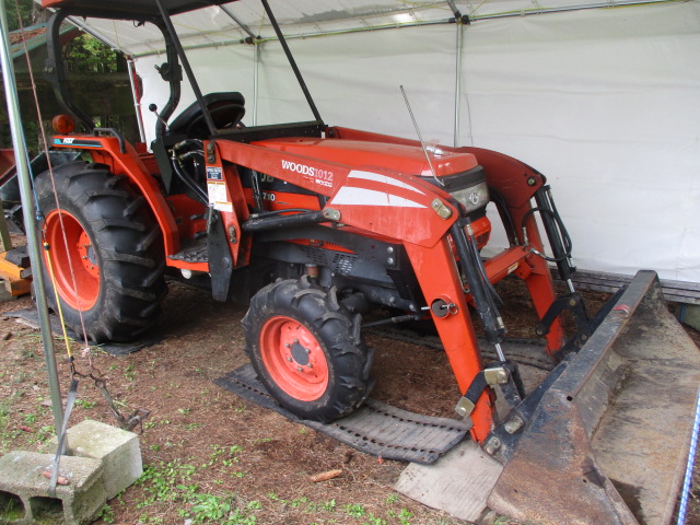

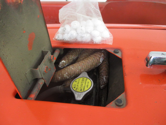

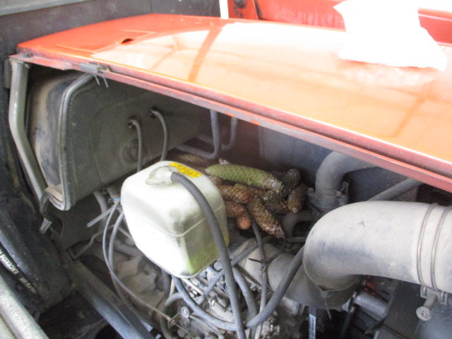

Uggg...... See pictures :(
Tractor basically sits outside, under one of them Harbor Freight car port type of shelters.
Open on 3 sides, 4th side / long side backs up to a row of pine trees. Pines trees that have a lot of pine cones..!!
When i leave camp, I put a bag of moth balls on the radiator one on top of the dash, and another under the seat..... hoping to keep the critters away.
Well.... as ya can see, the moth balls have no effect.
The red squirrels , ( I believe they are red squirrels that are doing this ) brought all these in this week. I was up at camp last weekend and was just there this past Saturday.
I picked them all out, looked the motor and tractor over real good, got the leaf blower and blew everything out / off and started the tractor up. All was good .
After i was done for the day, backed the tractor back under the shelter , let it cool, and put the moth ball bags back on the rad, dash & seat.
I left the side panels off so hopefully the squirrels won't store any more pine cones in there seeing that it is all " open" .
Is there anything more i can do... to keep these squirrels out of there..?
What do you guys suggest.?

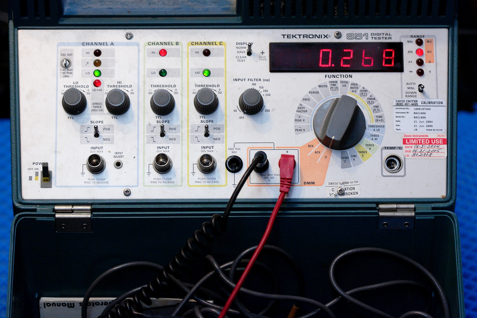

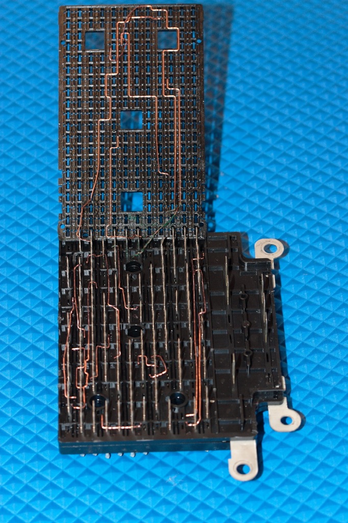

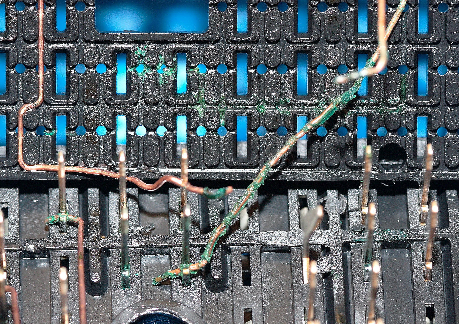

I don't have a squirrel problem but even with barn cats on my rural property, the 2006 GMC 2500HD I used to own got "moused" several years ago.
One morning I was getting ready to go into the village post office and I noticed the check engine light was on before I even put the key in the ignition, NOT a good sign. I turned the key on and the preheat light came on normally and the engine then started normally. It drove fine but when I got to the post office, turning off the key left the engine running and when I got home I had to pull the ECM relay to kill the engine. I was busy that day but the next morning I planned to troubleshoot but everything worked perfectly as it should.
Over the next couple of months it showed its odd behavior a couple of times. The only trouble code indicated was loss of communications with the separate TCM for the Allison transmission. I spent a few hours reading the service manual and the next time it acted up I was ready to make some key measurements. I found that when it was in a fault condition, with the key off connecting the batteries would cause the ignition switched 12 volt line to slowly begin rising from zero and when it reached a few volts the ECM would activate the relay energizing the switched 12 volt line and the CEL would come on.
I traced the problem to leakage between the constant and switched 12 volt lines in what GM calls the UBEC (underhood bused electrical center). The top layer contains the plug in relays and fuses, the bottom layer has several large multi-pin connectors that connect to the various wiring harnesses and the center layer is where the problem occurred. It has bare copper wire in a grid that provides the interconnections. A mouse had used the top layer as a urinal and this caused corrosion of the copper in the middle layer. When the humidity was high enough (thus the intermittent nature of the problem), there was sufficient leakage via the corrosive residue to energize the switched bus and slowly charge bypass caps on that bus until it reached a sufficient voltage level to wake up and energize the ECM. It took about four hours of reading the manual and making measurements to find the problem, a used UBEC from an identical model via Ebay was $50 shipped and installation was an easy 20 minute job. Both garages have since been equipped with multiple mouse traps which get checked regularly, especially during harvest. One of the barn cats learned to recognize when I was doing this task and would follow me to harvest freshly killed mice.
Images of the UBEC and damaged area below, the last shows resistance between the constant and switched 12 volt buses which should have been infinity but dropped to under 300 ohms once I had raised the humidity to 70% in a box containing the old UBEC.
