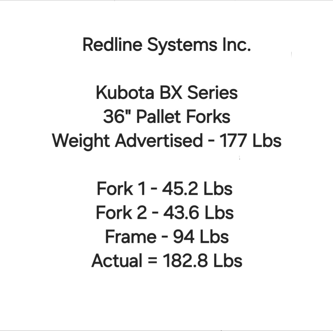

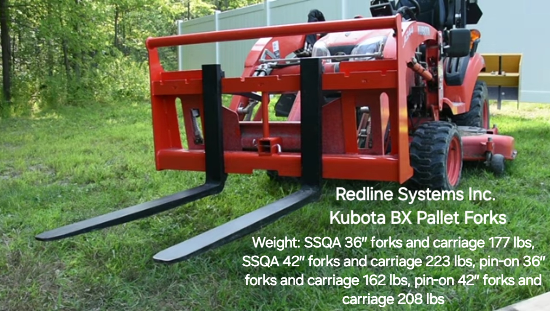

I have Redline Systems, 36" set.
Keep in mind, the more the fork-set weighs, the less the machine can lift.

What tractor do you have? If you don't have a ballast box for your 3 point, get one. The ones from redline are light but whatever you mount on your loader, you lose that much in lifting capacity. The ballast box compensates for that. I have around 250 to 300 in mine and helps allot.

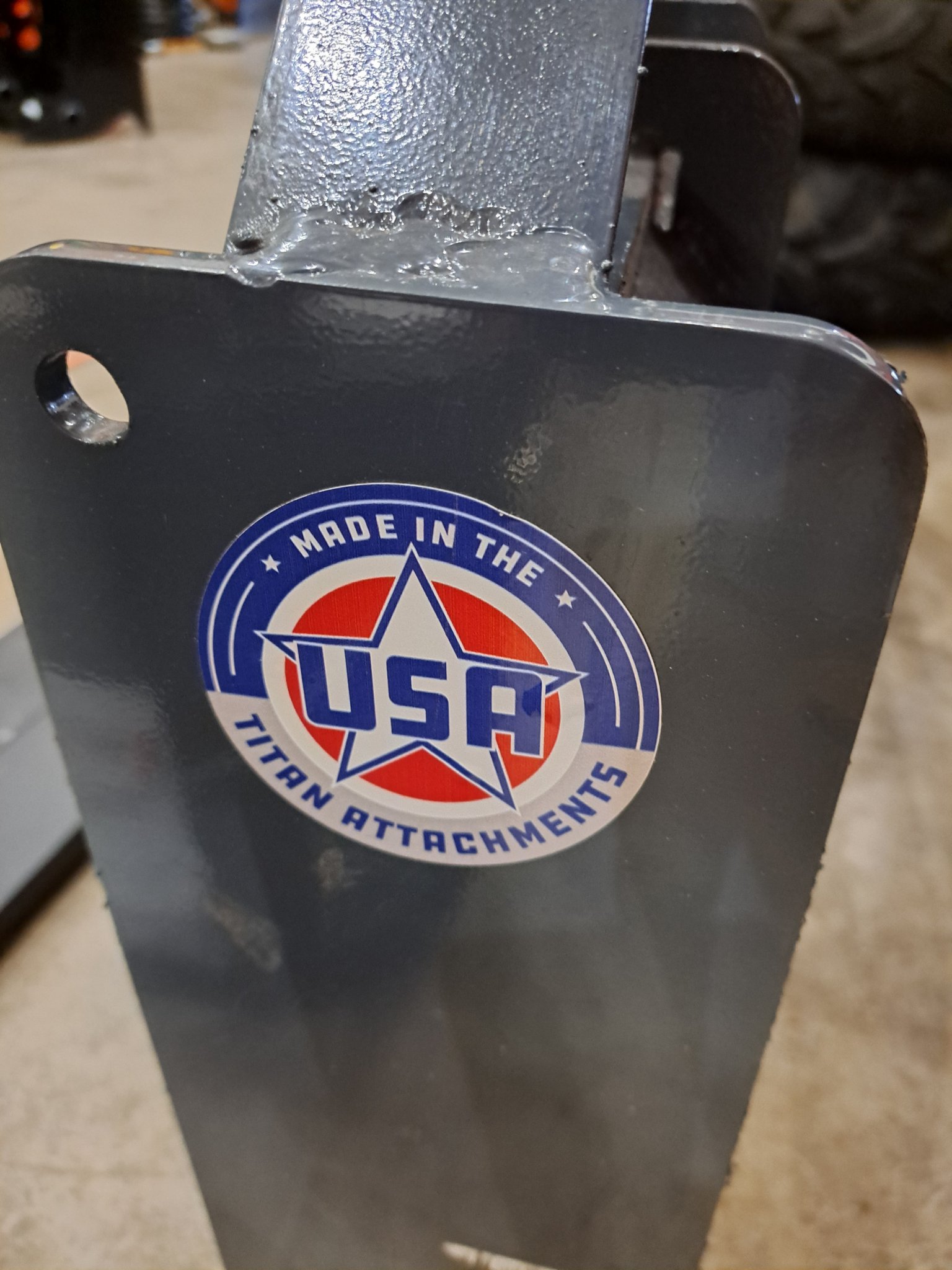

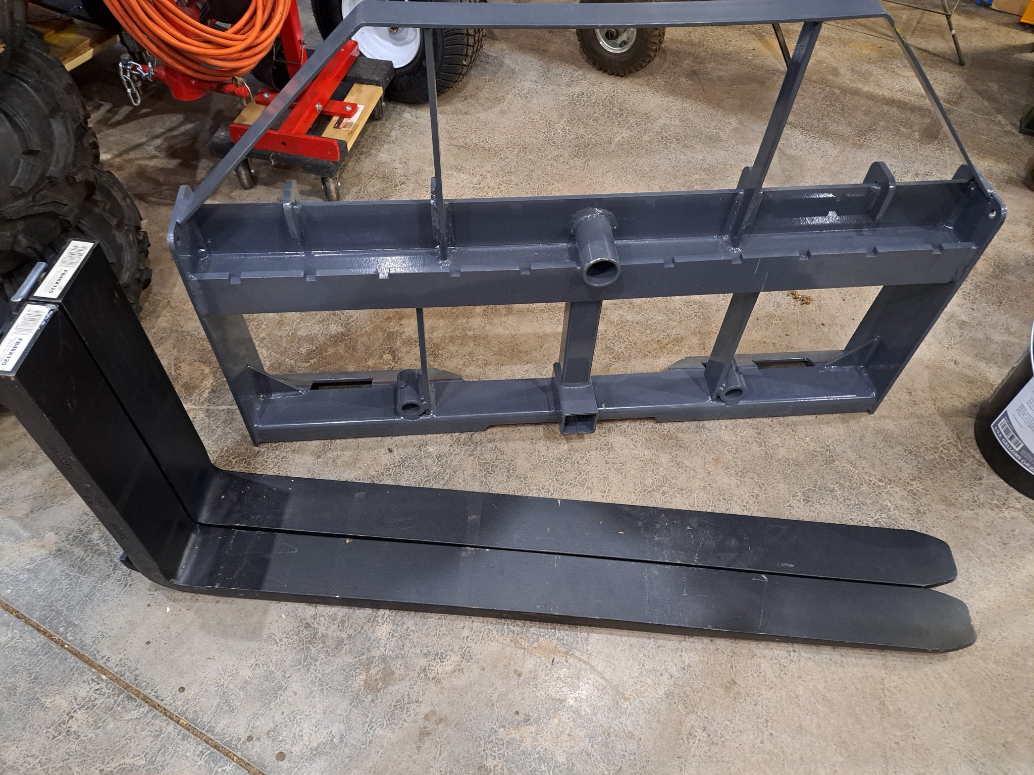

I recently bought the Titan USA made 48 inch set and it's nice but over 300 pounds. You don't need the 4k rating with a bx and may want a lighter set for a BX
