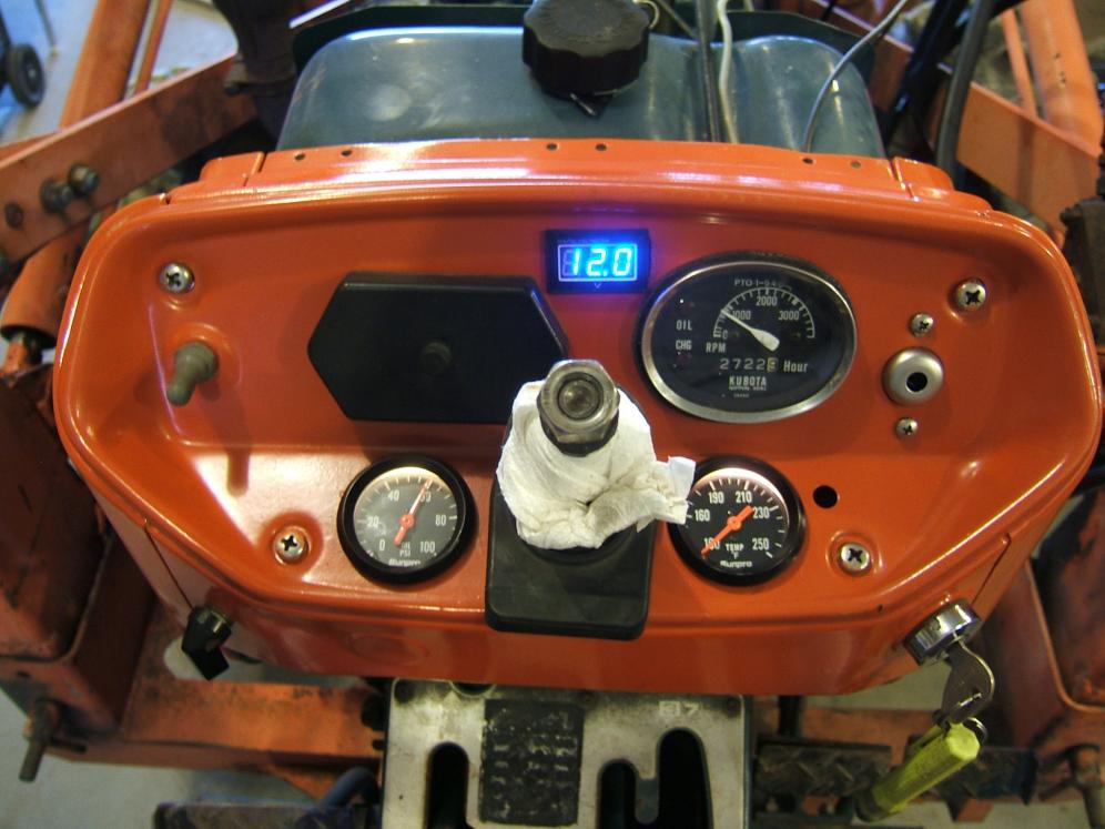

I am looking for recommendations for oil psi and water temp gauges - some that you have used. I installed 2 Sunpro gauges and both failed within 4 mths. :mad:
I now have two 2" holes :eek: in my dash that need filling.
Mechanical or electric are both ok with me.
Not looking to spend allot of $$.
I know that others have posted on OTT but \I an getting to many hits to filter through, allot having nothing to do with what I am looking for.
Thanks for any and all replies.:)
P.S. Open station and lives outside sometimes. Water resistant or waterproof needed.

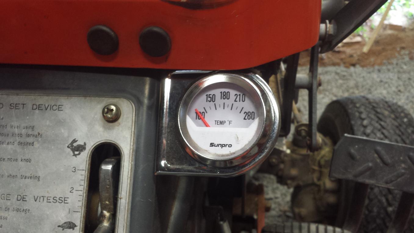

By the looks of it, the gauges that he has fitted are Sunpro and have failed.
"LED" gauges should not be affected by cold, and he already has one for Volts.
However, I'm not saying the ones I listed are any good, and they may fall apart just as quickly!
If you silicone or glue (neutral cure) the boards in place and seal the glass you may get more life out of them, who knows!

Thanks everyone for your replies and sorry for taking so long to reply back. I would like to stay away from the Sunpro gauges. They are what I originally installed and failed in about 4 mths. I talked with three different suppliers of the Sunpro gauges and they all said that a bad batch of gauges had been produced. I got my 2 gauges from different distributes because neither had both in stock.
Hokie, how long have you had yours installed? I also got mine from Amazon. Because of all the trouble they have had with the Sunpro gauges they immediately offered a full refund or another set. I took the refund.
The digital voltage is inaccurate but it is consistently of by the same amount so I can live with that.
When I installed the gauges, I put an O ring between the gauge and the dash, silicon ed the back and around the glass. Also, all electrical connections were soldered and heat shrunk. I tried to cover all the bases.
Thanks again and all responses welcome.:)
