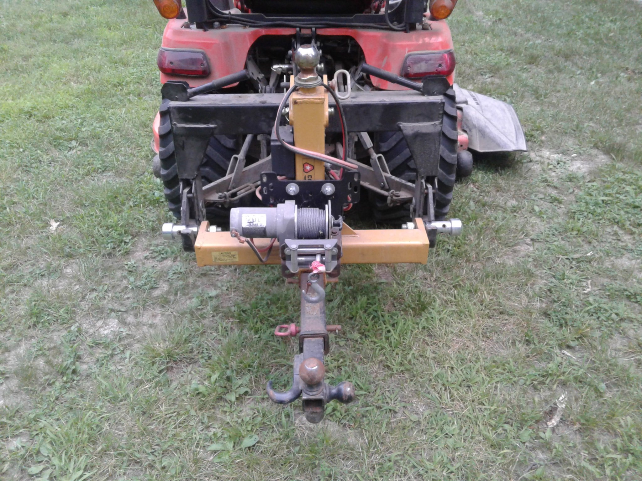

I use a modded TSC trailer mover to move empty 16' equipment trailer and dump trailer all mowing season - don't bother locking hitches to trailer ball.

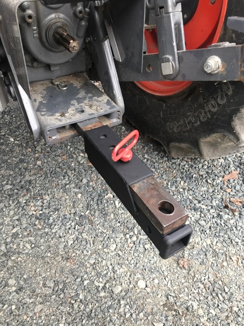

I had this made for over the drawbar. The 3pt could lift up..... likely not in your case but... I got a cheapie 3pt receiver T bar off Amazon that works. If you have any scrap tubing, welder and an hour of time, you could make one for your purpose!

I had this made for over the drawbar. The 3pt could lift up..... likely not in your case but... I got a cheapie 3pt receiver T bar off Amazon that works. If you have any scrap tubing, welder and an hour of time, you could make one for your purpose! View attachment 51168
I originally thought about using the draw bar. Some of my trailers are hauled by larger trucks and the hitch is 2 feet off the ground. Others are about 15 inches off. So being able to raise and lower the hitch from the tractor will be easier. I will however have a big D ring on my draw bar.
