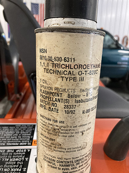

I used my part's washer when I rebuilt mine. Trichloroethane (had to take a pic of the bottle, haha) is also great stuff, just don't breath it in, or get it on your skin!

It's what I use, as it'll 'flush out' the residue.
I used to use trichloroethelyene ??? Some big,long mouthful of letters. would get 45g drums of it for free (used coolant for SCR motor drives ). It worked GREAT at cleaning carbs and trannies and such.....
probably banned now of course.....
Yeah, it's banned for being hazardous to the Ozone layer, as well as for being a potential carcinogen. It was good stuff for degreasing, though.
