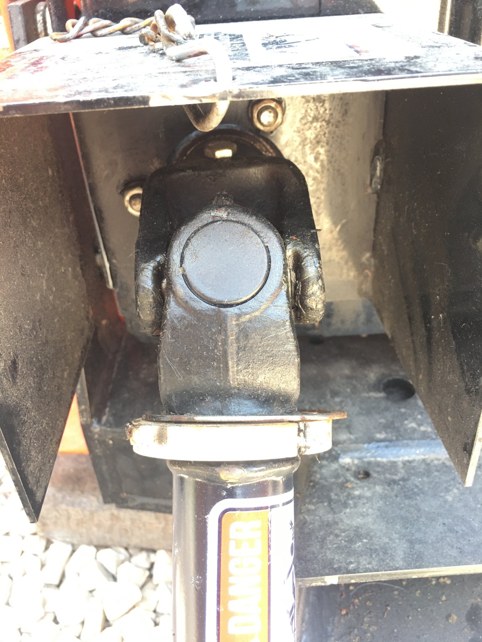

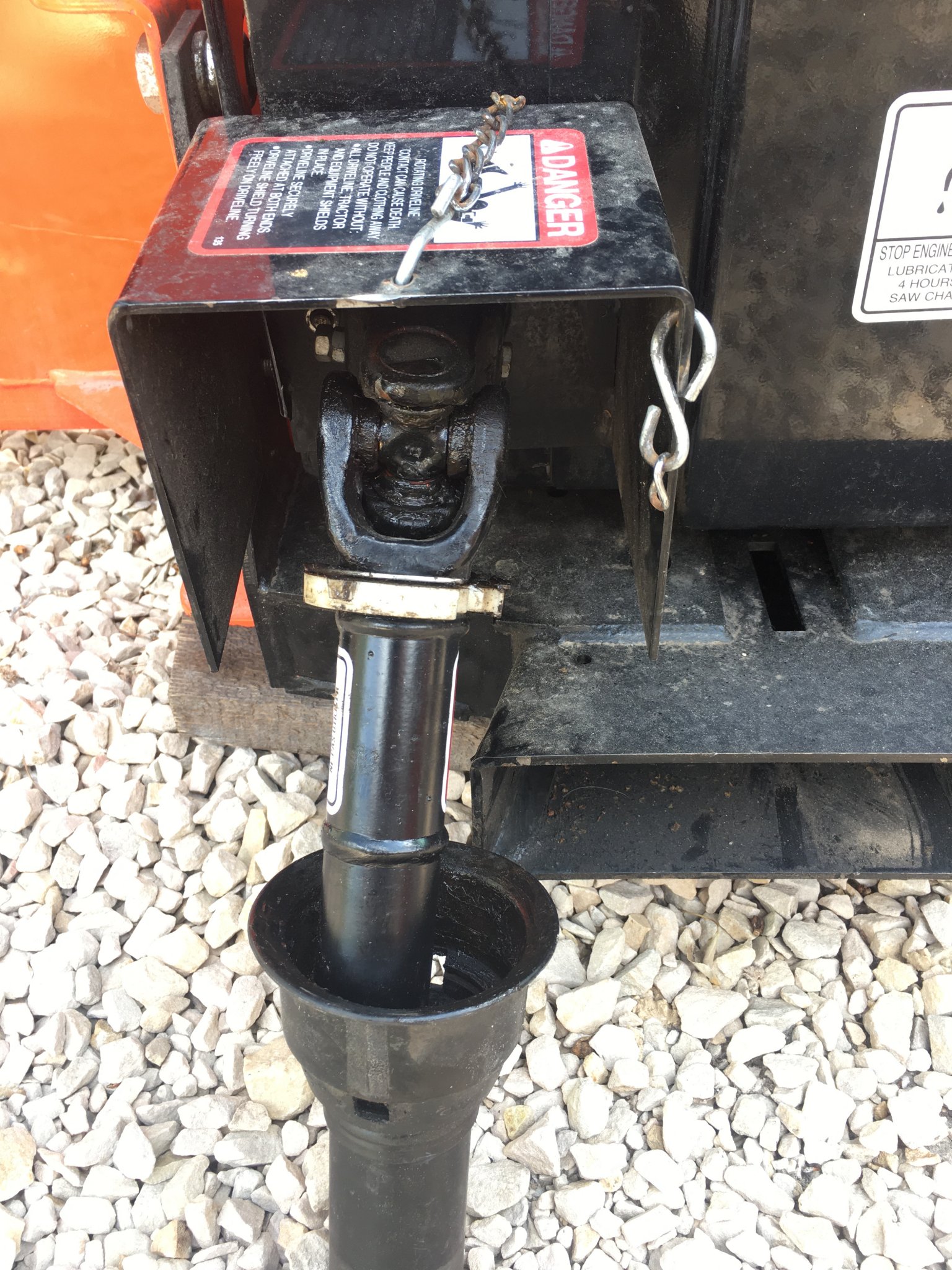

So I’m fairly new to tractors and was checking my PTO connections on my B2782B snowblower. I removed the protective cover on the PTO, which was fairly easy to do, but trying to put it back on is another story.
There is a retaining ring that fits in a groove in the cover that needs to be set in place from the inside but getting to it without removing the entire yoke from the snowblower is impossible to do because of the metal housing on the blower.
So before I disconnect the shaft from the blower I wanted to make sure that’s the only way to access the retaining ring to set it in place?
This seems rather complicated comparhow easy the cover came off.
What am I doing wrong?

I removed the plastic protective cover on the PTO shaft which is attached to my B2782 Snowblower. There is a metal shield on the snowblower (see photo) that protects the yoke assembly on the blower. Because of that metal shield I can not reattach the plastic PTO cover because I can’t get to the end side of the shaft to reach the metal retaining ring that holds the protective PTO cover in place. Looks like I have to remove the blower drive shaft yoke and PTO shaft (all one assembly) from the blower to get to the end of the PTO shaft parts.
I am hoping there’s an easier way to reinstall the plastic protective PTO cover without removing the entire shaft from the blower.
Does that make more sense?

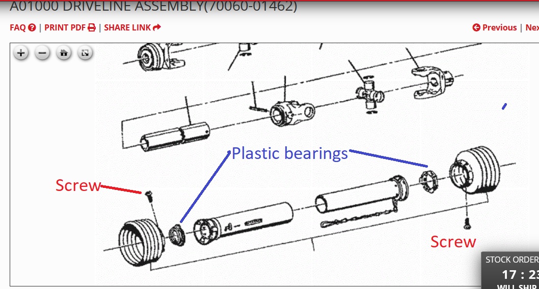

I looked at the parts diagram and will give you my thoughts
At each end of the pto guard there is a plastic bearing. These bearing permit the metal internal shaft to rotate while the outer plastic shield remains stationary held from rotating by chains at either end.
I think you will find the plastic bearings are split to allow you to spread them in order to move them to the right position.
Once the bearings are in place the outer shield halves (tubes and big ends) will engage with the bearings. Look for slots in the outer shield where fingers on the bearings can slip into and turn a bit to lock in position.
Each end has a screw to lock the outer shield to the plastic bearing.

Try to turn the white plastic bearings so the tab is at a known clock position (say 3:00). Then turn the black shield so the slot matches that position (3:00) then carefully slide it forward and over the white bearing. You may have to adjust the position to get the black slot over the white tab. Should snap in place or install the screw as noted above.

Well, thanks everyone for your input.
The only solution I could find was to remove the yoke and pto assembly from the blowers drive shaft so that I could gain access to the end of the shaft.
What is not apparent to this protective shaft cover is that it has a metal snap ring that holds everything in place. And the only way to gain access to it is from the end of the shaft, which means it has to come off the blower. Even with the shaft removed it is still challenging due to limited access space around the plastic protective cover and the yoke.
So a simple five minute task has turned into a thirty minute project.
All appears to be good now.
