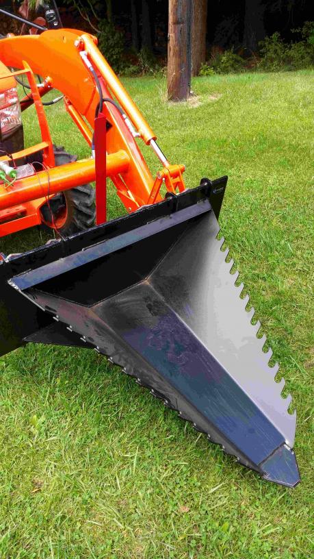

Here's a pic of my prototype. I want to use it a little before adding the finishing touches like protective covering for the wires. I'm using a simple backup camera I ordered from Amazon. Haven't had a chance to use it much yet, but I did pick up a stone with my tree stump bucket that I couldn't see at all without the camera. If you use one, make sure to wire it so you can easily disconnect it from the tractor when taking the FEL off... My first impression is this thing is the best thing since sliced bread! :)
YMMV,
Ted
