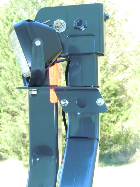

Well I installed the L8327 rear work light kit on my L3800 yesterday. It was a very easy installation. Since the wire harness on the tractor has a connector already in line, the work light just plugs in. The light bracket is about 1/8 inch thick and attaches to the ROPS. I don't know the wattage of the bulb. The light housing does have a switch. I will see if I can post a couple of photos.

Here are a few photos of the light. The instruction sheet that came with the light says it made for L3130, L3430, L3830, L4330, L4630, L5030, L3200, L3800, L4600. It sure is bright. I think its a 35w watt bulb. It was real easy to install. The first photo shows how it connects to the connector already in the harness. Can't wait to scrape some snow to see how it works.

Looks like a pretty good arrangement! You'll be needing sunglasses...
