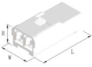

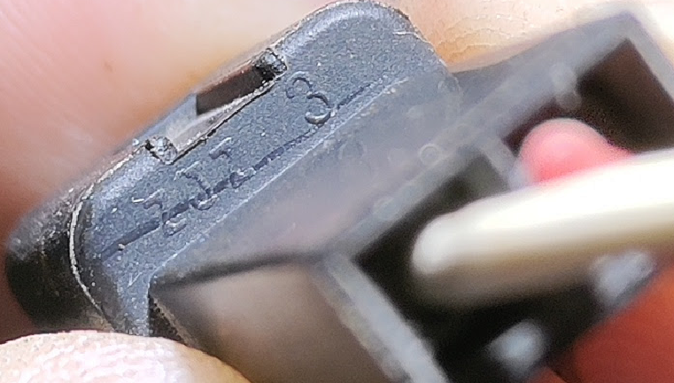

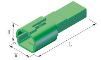

It took me a bit but I finally found the OEM connectors.
ZJZ marking on the OEM connector indicates that it's ZJZ United Co
Searching ZJZ's catalog showed me the following-
DJY7021-2-21 for the tractor side-
DJY7021-2-11 for the light side-
Unfortunately it doesn't seem like any US electronic component suppliers carry it so you're stuck with ordering from foreign suppliers from Aliexpress, eBay, or Amazon. Just search Google images for either part number and you'll find numerous vendors selling the connector sets along with the terminals.

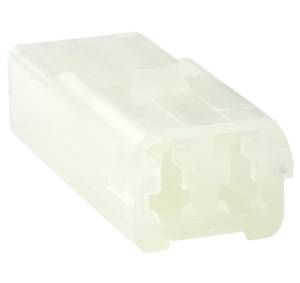

Edit- found alternative part numbers sold at Mouser Electronics.
Tractor side-
Yazaki housing 7123-1520
Yazaki female terminal 0.3-0.5mm2 7116-1180
Yazaki female terminal 0.85-1.25mm2 7116-1181
Light side-
Yazaki housing 7122-1520
Yazaki female terminal 0.3-0.5mm2 7114-1170
Yazaki female terminal 0.85-1.25mm2 7114-1171
