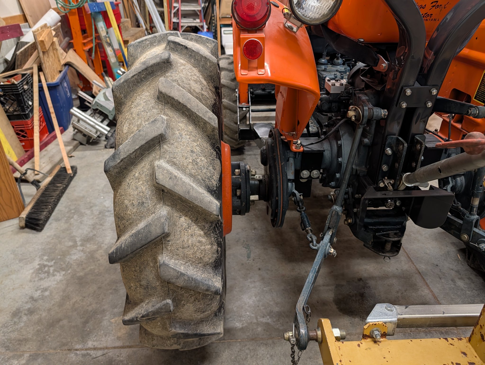

It still has the original rims and AG tires from the factory. They are installed for the widest setting. When I got it, it just didn't seem that stable and I live on a hill. I plan to fill the tires but was thinking 2" wheel spacers would give me a little more stability. Currently the rear wheels stick out past the fenders.

Can you post a picture of them?

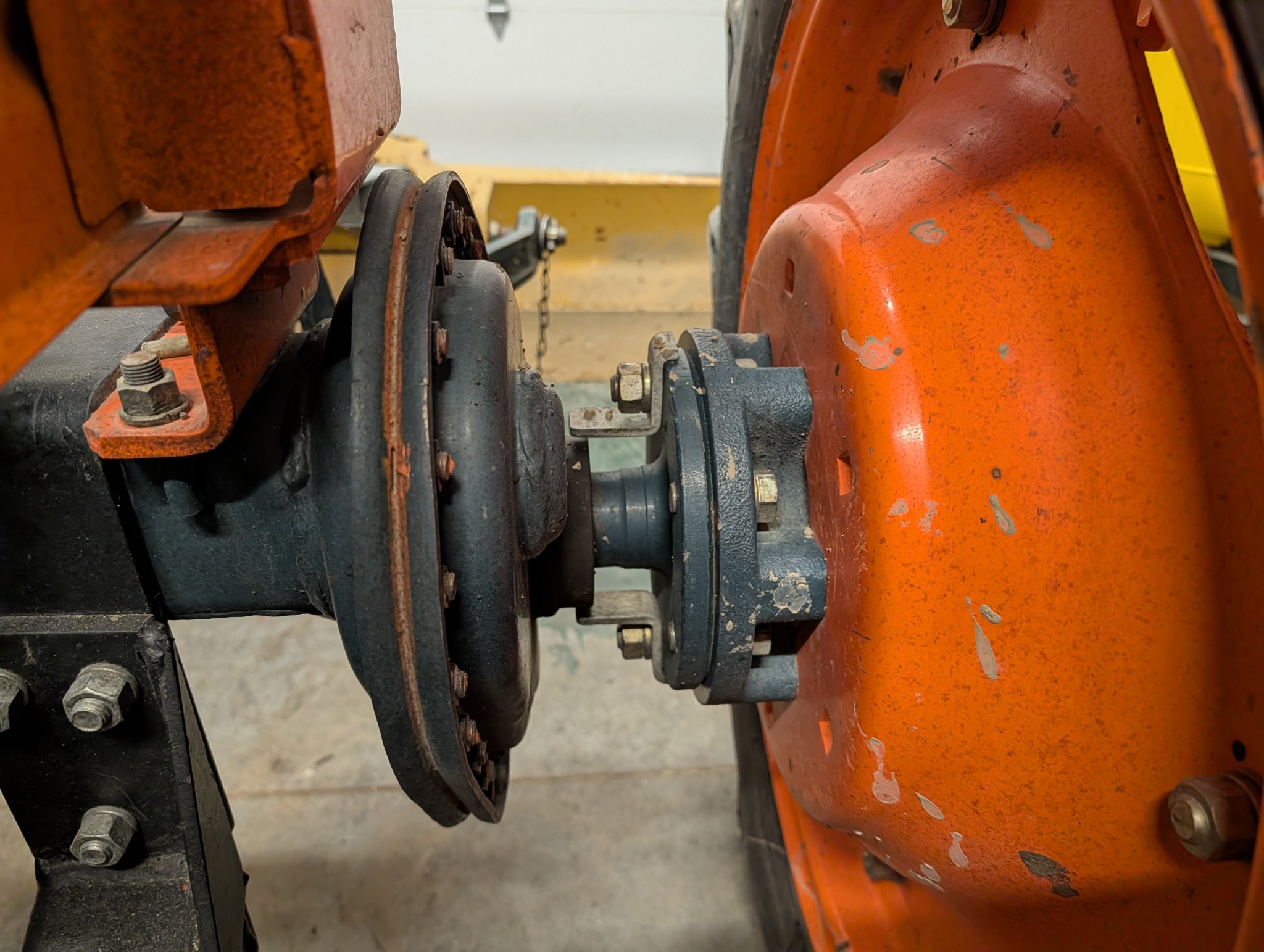

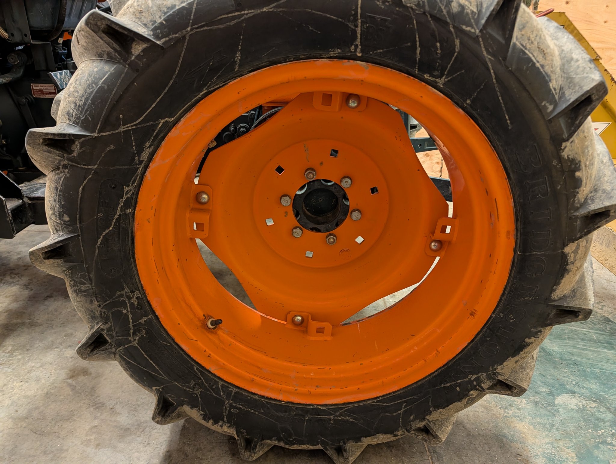

Post a picture of the rear wheel rim connection to the wheel center. I think there may be some adjustments there also, but not sure what you have or what the L245 was supplied with.
If it is part number 34220-27660 for the center disk that fits 42 different tractors. That disk and rim combo should give you more width than you need probably-if you can figure out the right combination of the arrangements.

WOW!!!!
Ok to start with yes you have them as wide as they will go on the rims.
That already has a spacer or maybe an adapter on it.
You do not want to go any wider on that setup.
I'll also caution you on loading the tires, while that will help with stability, but because of the width your at now, it's going to add a huge load to the axles and bearings.
You would be much better of changing it to a wider tire and rim like my L3450

First we need to figure out which rims you have, then I can tell you if other rims will fit it.

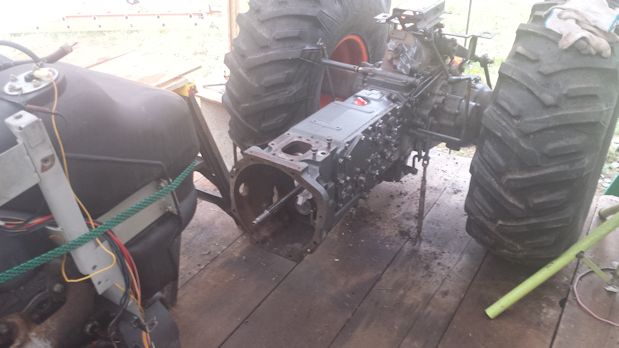

I would not go any wider. You will have bearing trouble. This is a weak spot on this tractor. It looks like you have a loader that will add to the problem. These are great tractors but they do have their limits. It looks like the axles have been apart already.
