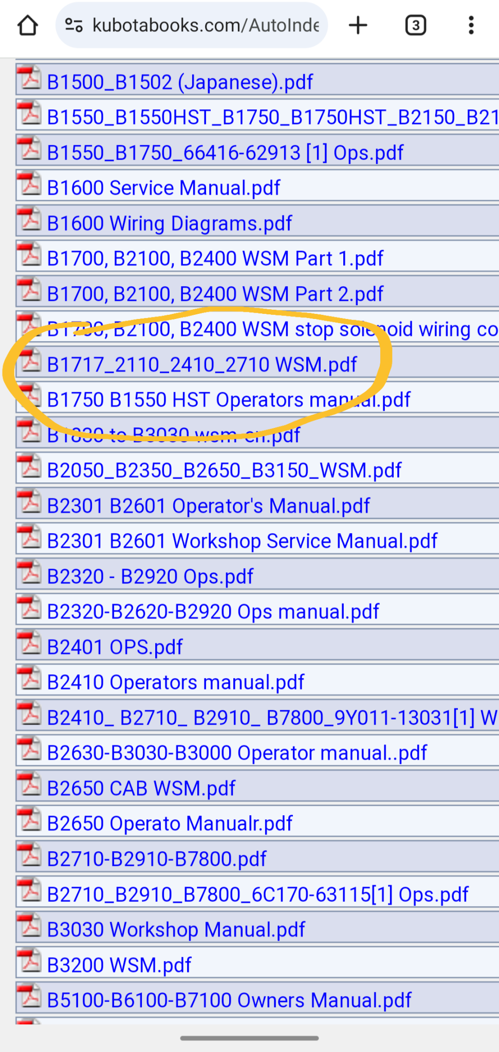

Check out the WSM and ask questions along the way.
