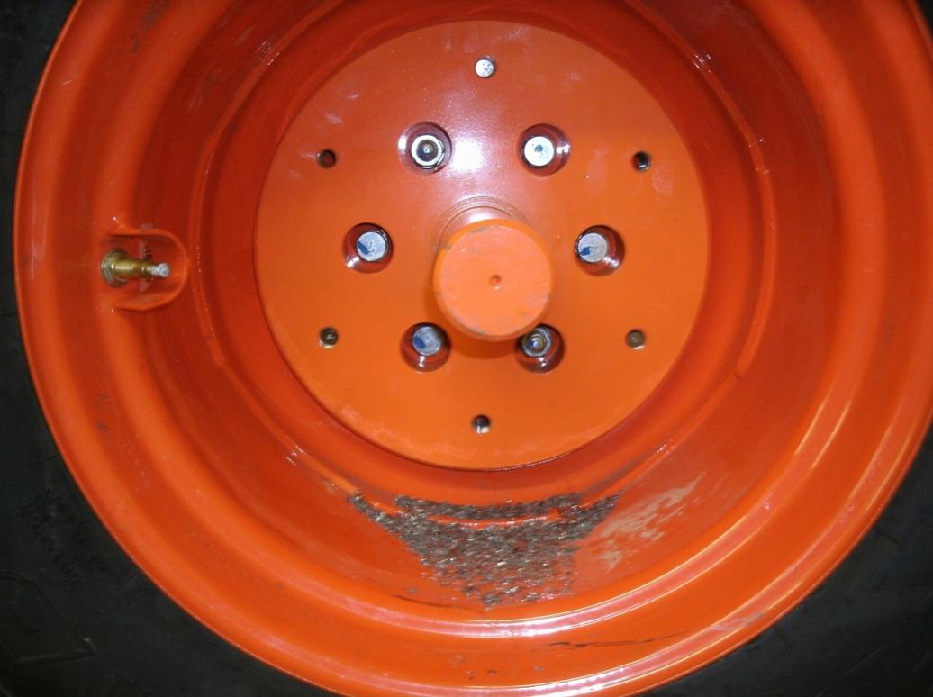

'filled' ? With what.... calcium, beet juice, ww fluid ??
If all you move is light, bulky stuff like wood chips, ballast not necessary but with dirt, rocks, firewood, ballast IS needed.
The HUGE problem with calcium is the corrosion from weepy valves and thorn punctures. I've lost 6 D-14 PA rims to it !! While 'technically' better to have the wheels loaded than hauling a weight out back, the cost to repair calcium damage is high.
If you're only doing occasional loadering, make/buy a 3pt weight box and use as required. If more than occasional, add some wheel weights.Lots of loader use, load tires with beet juice. If you have calcium, replace the valve cores every year and check they're in tight !
One very important issue are the FRONT rims ! Be sure wheel nuts are tight, tire pressure at max AND do NOT make turns standing still ! I lost both front rims on a D-14 as PO turned THEN moved. That stress fractured both rims along the bolt hole 'circle'. At least with down pressure, replacing the rims was easy but $$$ !

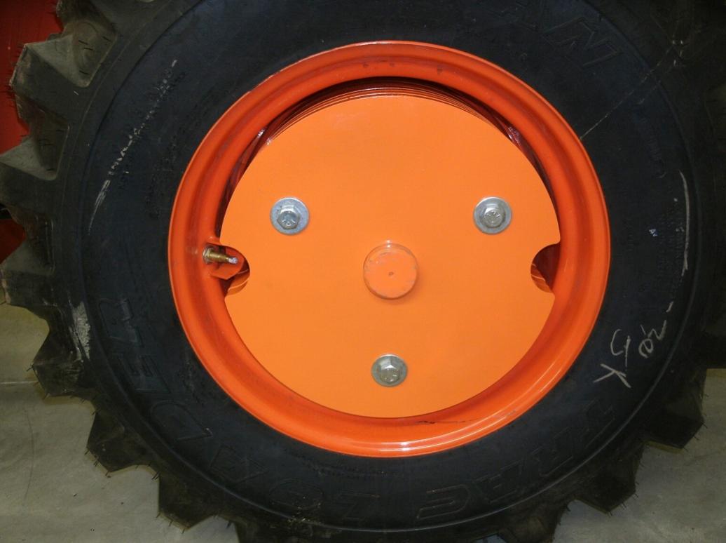

Dave_eng nailed it with the teeter totter effect. You will find that by adding rear weight will make the loader operate much smoother when you are handling heavy snow, sand etc.
Filled the rear wheel wells with steel on my L3901 plus I have the tires filled with Rimguard.

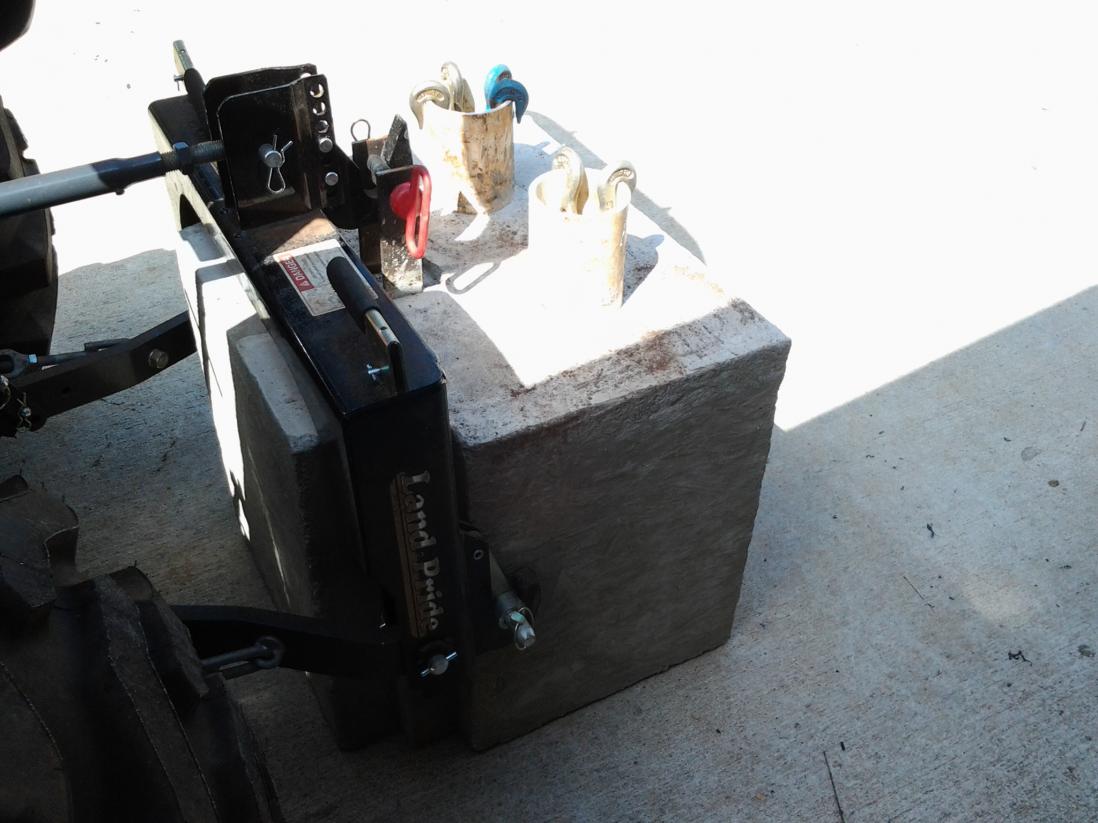

My LA243 loader manual recommends 420lbs rear ballast in addition to filled tires. My ballast box didn't work with my QH. So a couple weeks ago I picked up a heavy hitch that takes suitcase weights (picked the weights up at a local JD dealer - haven't had a chance to paint them yet)

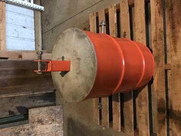

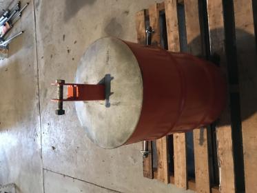

tjborowicz
Oct 16, 2018
12
Flushing Michigan
Maybe $30 wrapped up in the barrel. Had the barrel laying around, cut the top off, square tubing for the top link was laying in the scrap pile, bought the metal rod for $18. Had a couple bags of cement laying around and bought 3 new ones

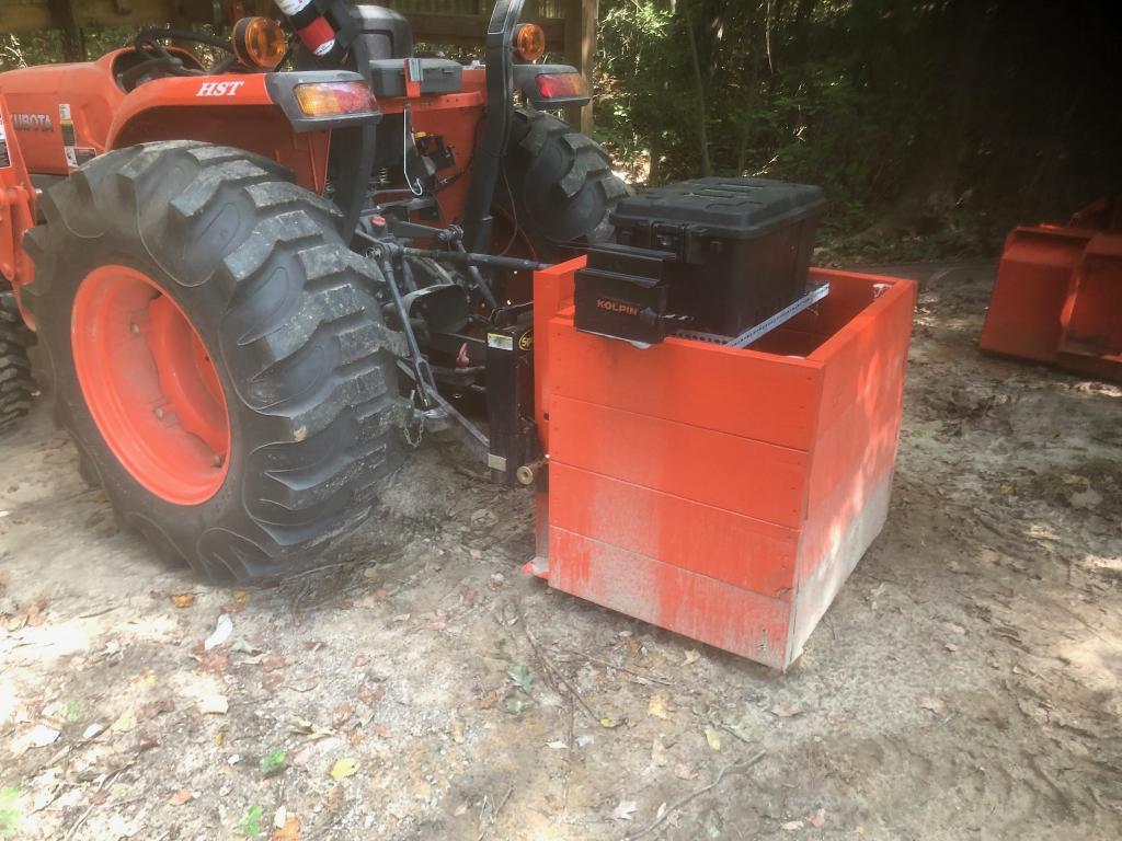

Coco2000
2017 L4701HST, pallet forks, 72 inch grapple
Sep 29, 2015
Pineville, LA
I framed a carry all with 2x6 treated to make a concrete form. I added (10) 80 lb bags of concrete. With the concrete, wood, carryall, and QH it weighs it at 1000lb. I have water filled rear tires which adds another 900lb. I tried to lift 4000lb of pavers and the rear never came off the ground so I figure I have enough weight. Also added 2 inch conduit for shovels and rakes, a frame to carry a large toolbox for tools, hardware, and tow straps, room on top of the concrete for chains, oil, and gas and two Koplin chainsaw presses mounted of the side.
