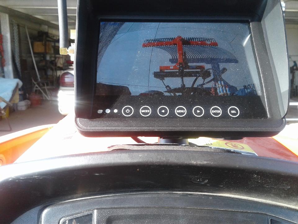

I installed two cameras because I just couldn't turn around as good any more. 1 to look down when I hook up and need to back close to thing and 1 to look to the rear when I'm driving. they are wireless & only need 12V power, the monitor is 7" and I powered it off the key so anytime the tractor starts up the camera is on.

I installed two cameras because I just couldn't turn around as good any more. 1 to look down when I hook up and need to back close to thing and 1 to look to the rear when I'm driving. they are wireless & only need 12V power, the monitor is 7" and I powered it off the key so anytime the tractor starts up the camera is on. View attachment 83635 View attachment 83636 .
I've thought about putting cameras on the front and back of my canopy so I could see my bucket/fork edge in front and avoid killing trees with the backhoe. I've thought about having 2 monitors so I could see either at a glance. How do you switch yours, one of those buttons on the monitor?
