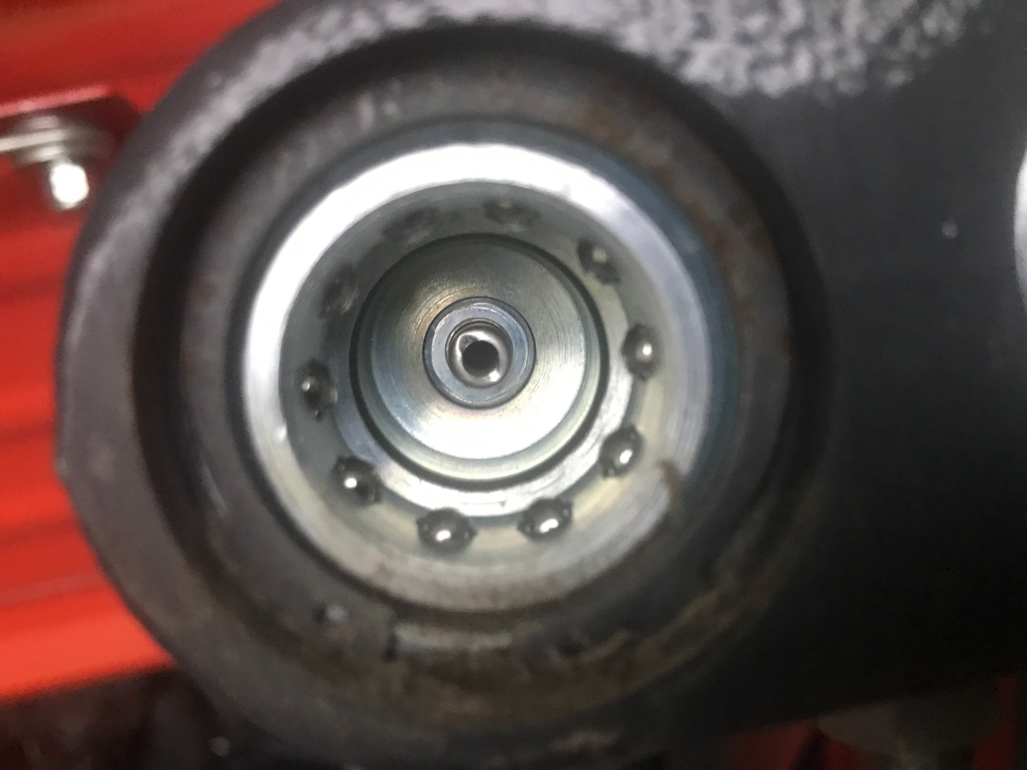

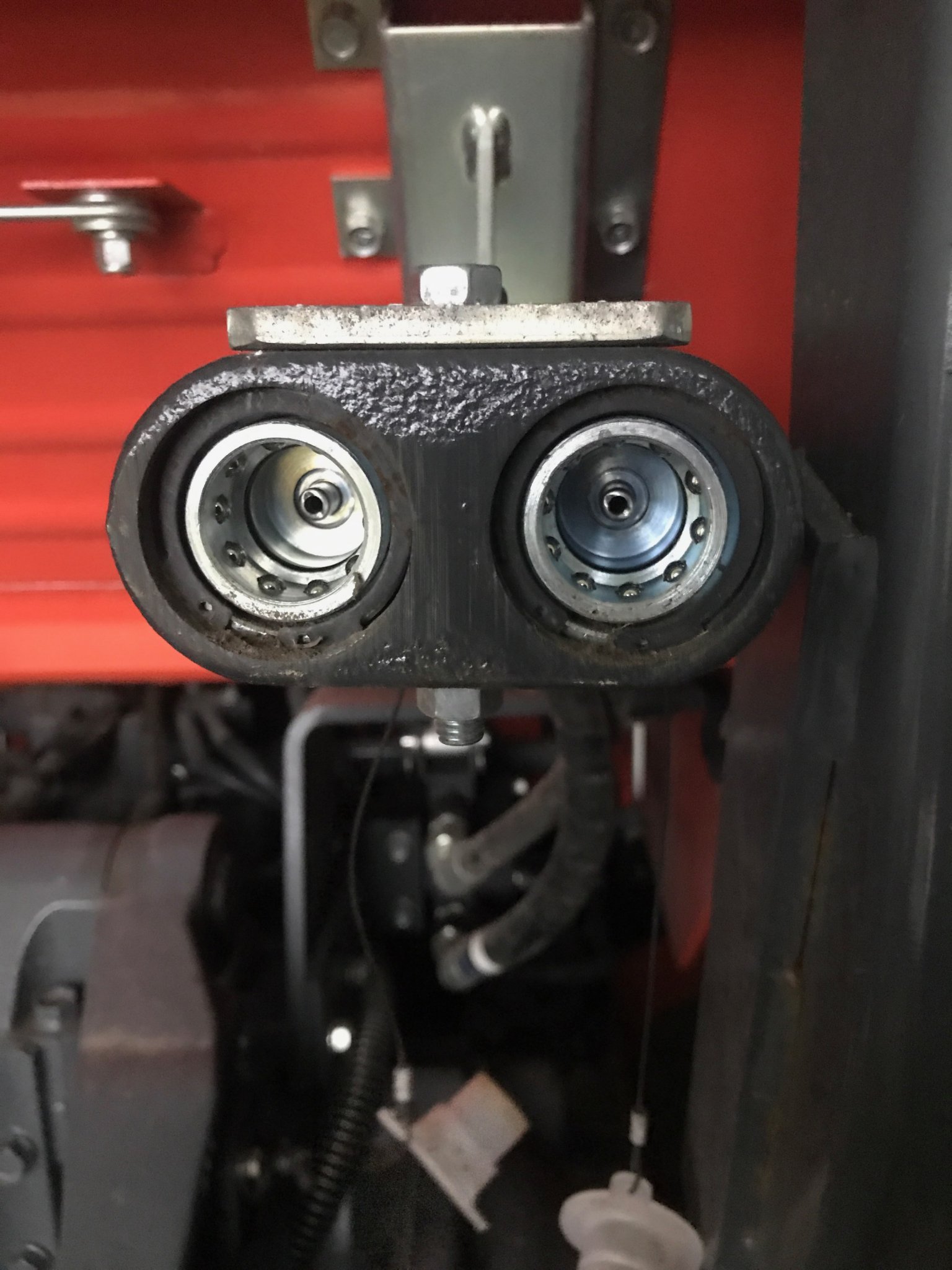

I have a L4760 with dealer installed Kubota rear remotes. Can anybody tell me what type of connector it is? I am going to purchase a hydraulic top link and want to br sure i get the correct connector for the hose.
Many thanks in advance.
SidecarFlip
Banned
7,182
562
Pioneer. Kubota has been as long as I can remember.
You really need to put dust caps on them. Bad to leave them open like in the picture. The crud inside goes right into your fluid.

Is there a size to them, other than hose size? My tractor is 500 miles away at the moment and i want to order the correct pieces
UpNorthMI
May 12, 2020
849
567
Up North, MI
Typically 1/2" that's what I purchase to fit all my tractors. make sure the lines you are buying have the correct fittings on the other end for the hydraulic top link you are buying. I'd recommend buying the top link and hoses from one source to ensure they are a correct fit at the cylinder. The tractor end is 1/2" pioneer male fittings.

Thats what i did. Got the cylinder and hose kit from same place, that way i know it fits. 270 for cylinder with check valves and hose kit
