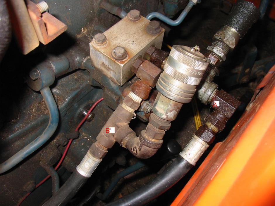

I have an L245DT . Does anyone know which outlet is supply and return under the seat where you hook up hydraulic hoses for a front end loader? Mine are not labeled.

I would like to learn more about them, you have a front end loader? With an open center system I would have thought one of the lines would have gone to the reservoir or have a power beyond

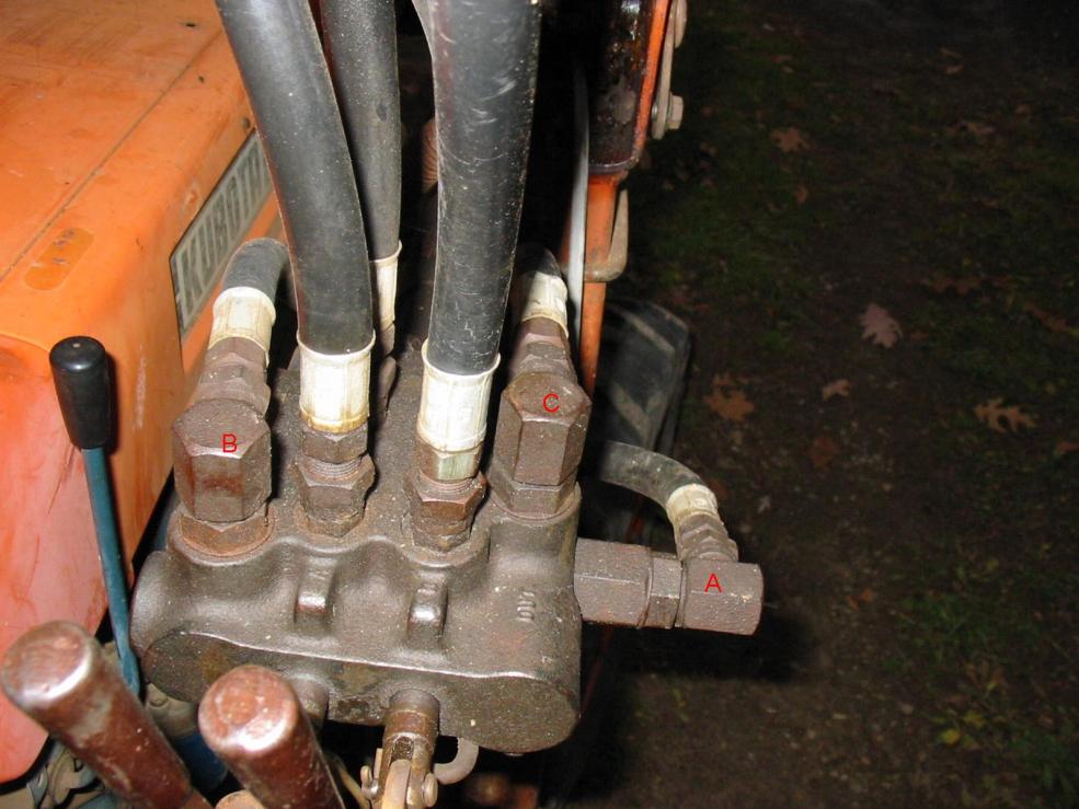

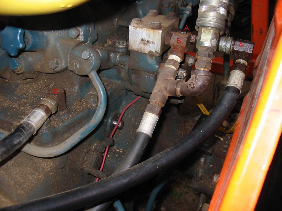

Hi Milo,
i know this is an old post but i was wondering how well (fast/slow) the loader operates from the flange outlet you are using under the seat? also, where did you get the aluminum manifold block that is mounted on top that the hoses are connected to? i plan to use the same flange outlet for adding rear remotes (log splitter), but not a loader.
