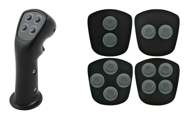

I referred to the multiplier that @JasonW installed as a diverter but that's really because of the way I'll be using the same multiplier. I have the four button Control Grip with momentary buttons which are pressed with the thumb while moving the in cab lever forwards or backwards. In my case only one function is activated at a time i.e. either extending or retracting one piston in one cylinder as the lever is moved while a button is pressed, so diverting oil for that one function. In @JasonW's case, he could extend or retract the piston on as many as one to four cylinders simultaneously by energizing one, two, three or four solenoids, so basically multiplying the output.

Well, no, since a multiplier is really a (multiple) diverter the expression in my humble opinion is correct. I think the multipliers should really be called "diverter with x outputs" but I think it's too late at this stage :)
The joystick with the pusbuttons looks like a great solution to me, only one hand required and hand can stay on the joystick for all controls.

The main issue with the multi-button aftermarket joystick handles is cost. They are very pricey....

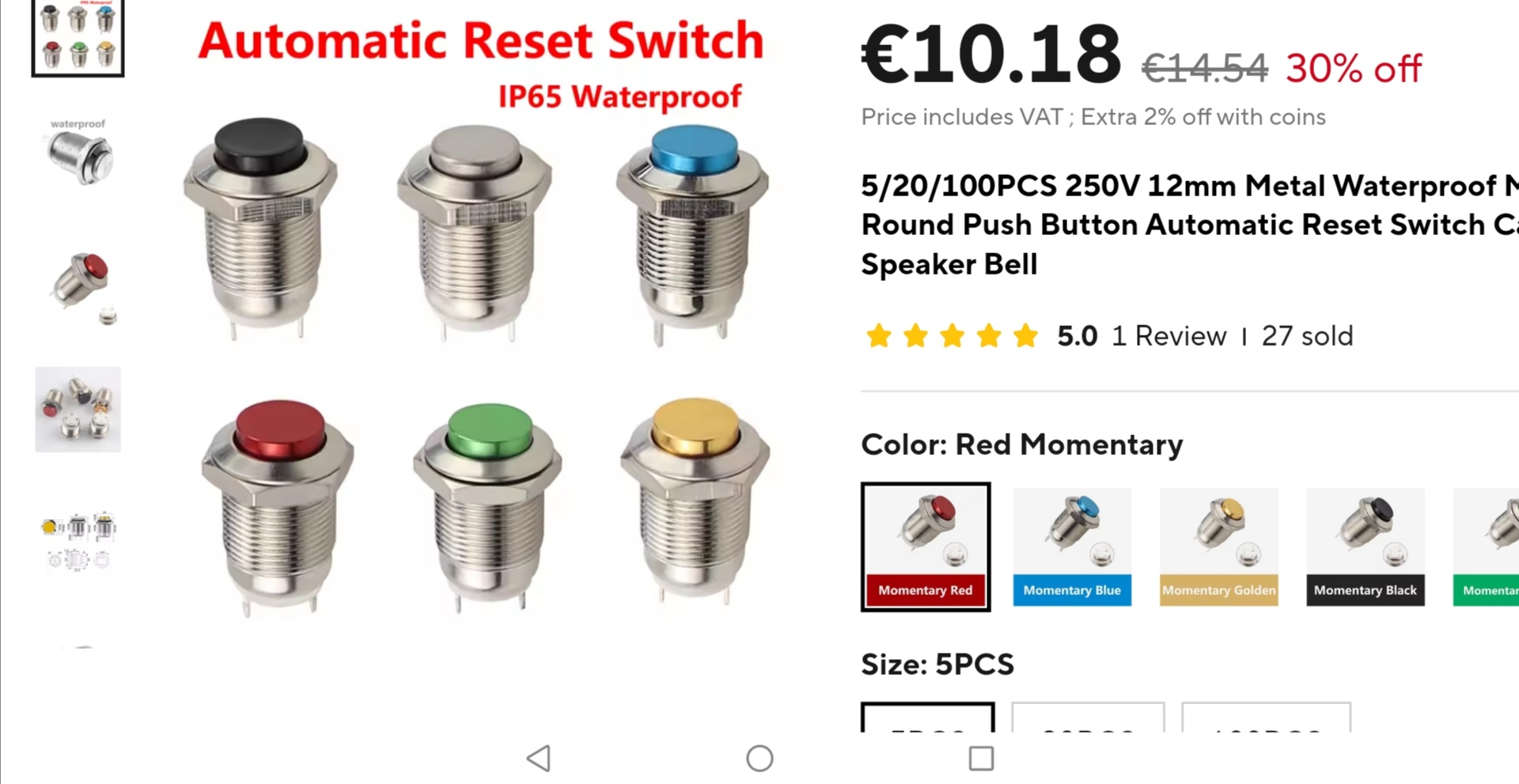

In this case I would buy a Mercedes W123 gear lever on Aliexpress for $7 incl. shipping, a set of IP65 rated pushbuttons for just over $10 and do a bit of DIY.

After @MtnViewRanch's recommendation I ordered and received a Scorpion X Series four button control grip and it was $250. "Pricey" is a relative term, and given that the multiplier costs $1,000, and the two necessary hydraulic hoses will be extra, the function, ergonomics and aesthetics of the control grip are worth the added cost to me. Also, I have no need to move two pistons in two different cylinders at the same time.
The black one is shown but I got the nicer, Kubota grey version.
I am surprised at that price - pretty reasonable. I would have expected 2x or more based on other prices I have seen.
I need to make a correction. It was $270 not $250, but still a reasonable cost for the control grip. It came from Canada so prices might be different in the near future. I will say that it's a very nice piece with every part of the kit appearing to be well engineered and well made. When I purchase the multiplier from Summit this spring I won't be needing the switch box.
