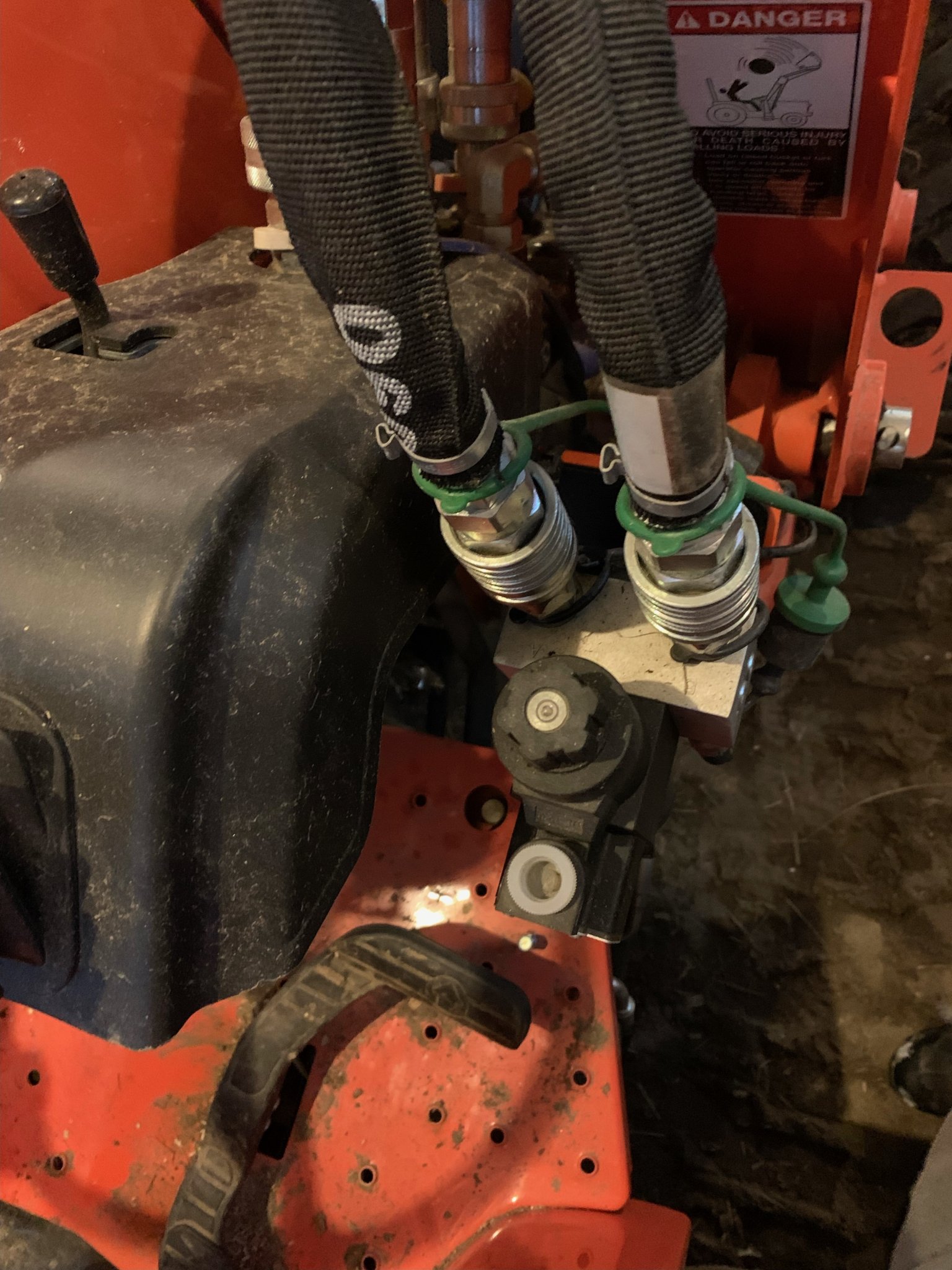

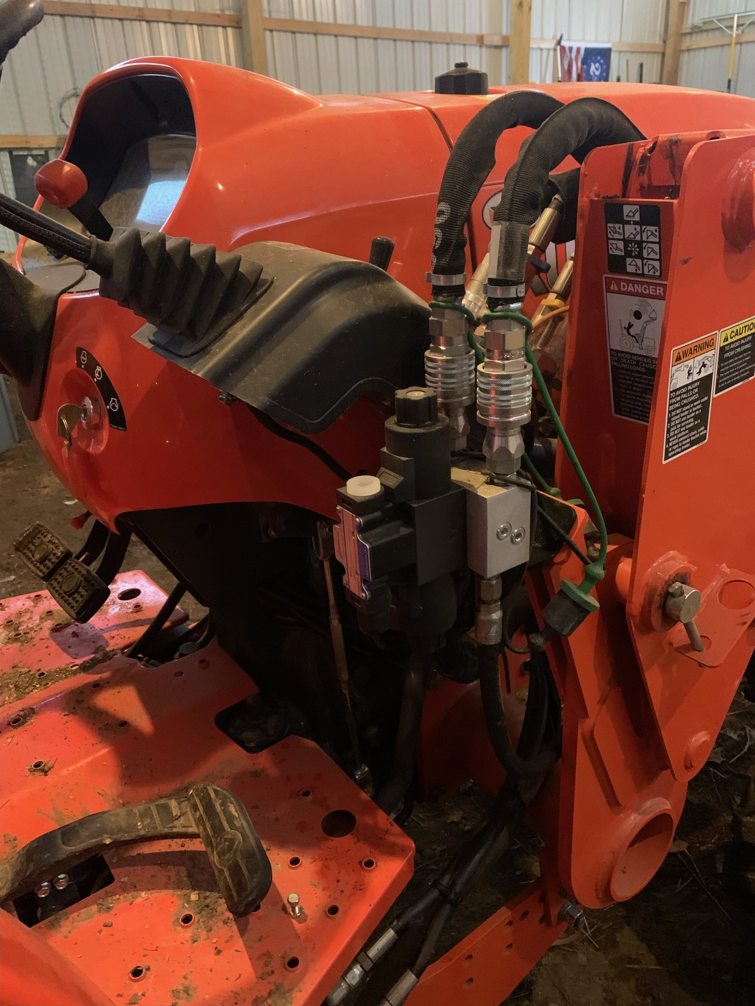

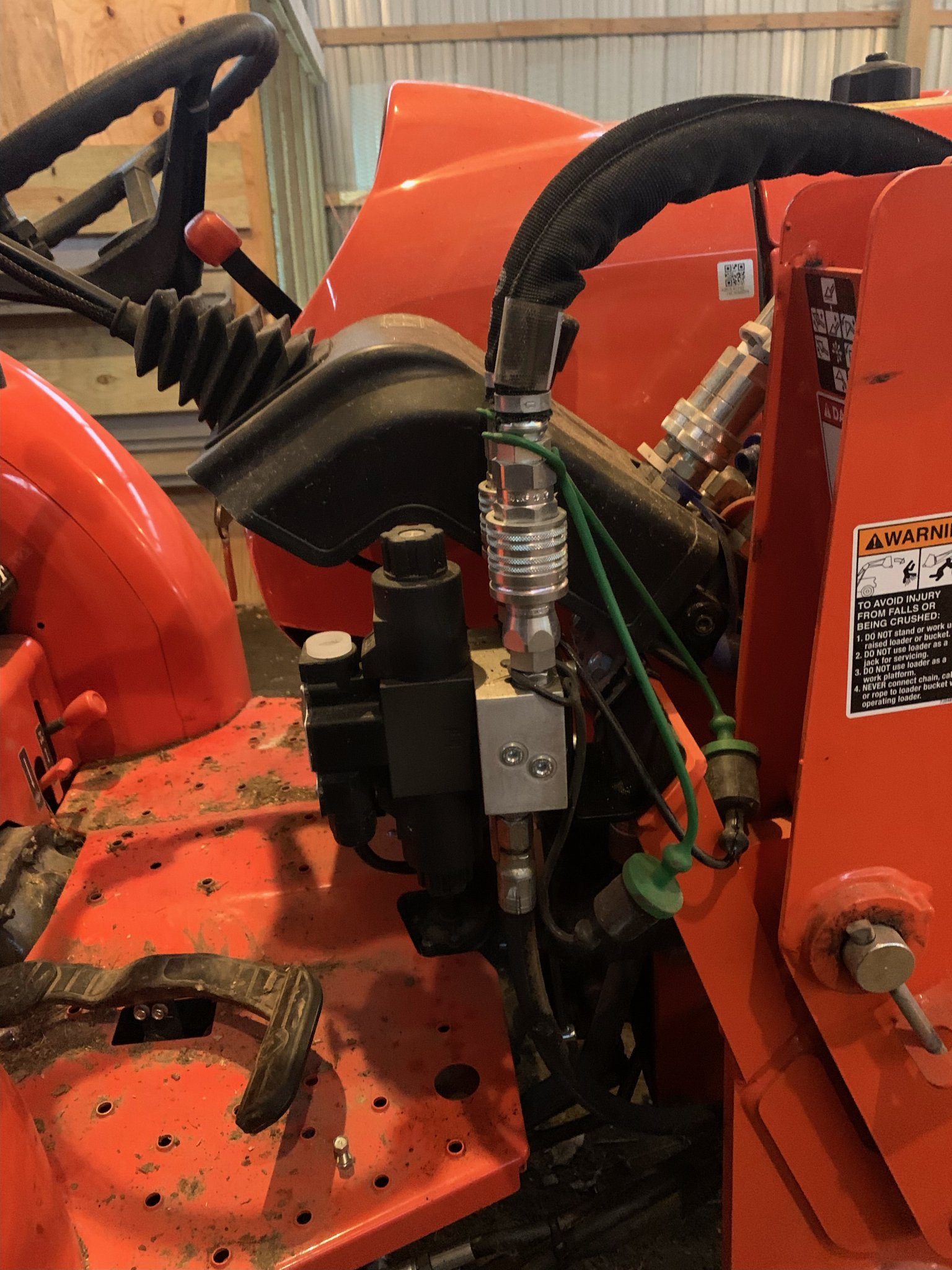

Unfortunately the third functions are almost universally manifold mounted D03 solenoid valves - you dont just add sections.

Very standard and as you can see that solenoid valve is mounted to the loader post in the exact spot the EZ-PZ kit mounts. They won't play together.
Thats a known issue and I just spent about an hour in the shop mocking up a bracket for ROPS mounting. As soon as I get a valve mounted and can verify the fit I will be sending a drawing off to get a few laser cut. The only difference is going to be the length of the hose runs so the price of the ROPS version of the kit will be just a few dollars more than the loader version but the reduced cost for the hoses for rear remotes will more than offset that. It will be a neater and cheaper way to add rear outlets.
