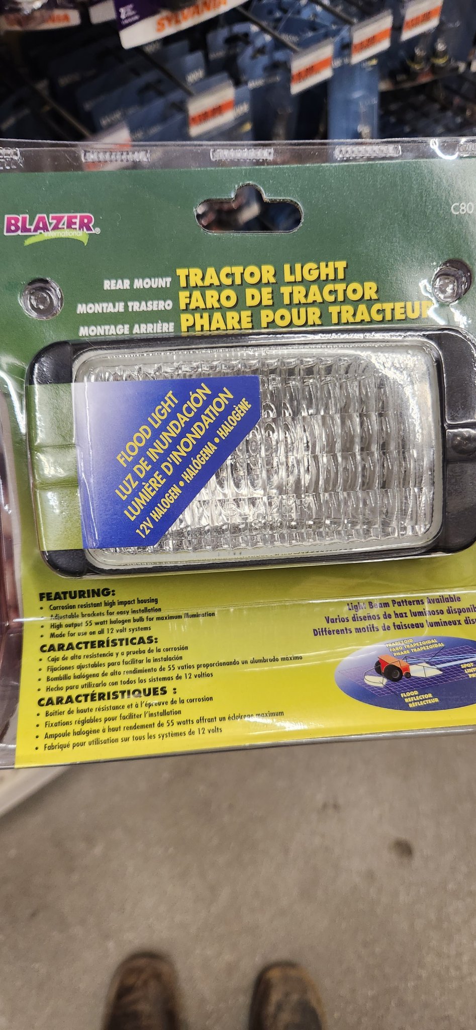

I found this light that'd seem to match or blend in with the tractor.

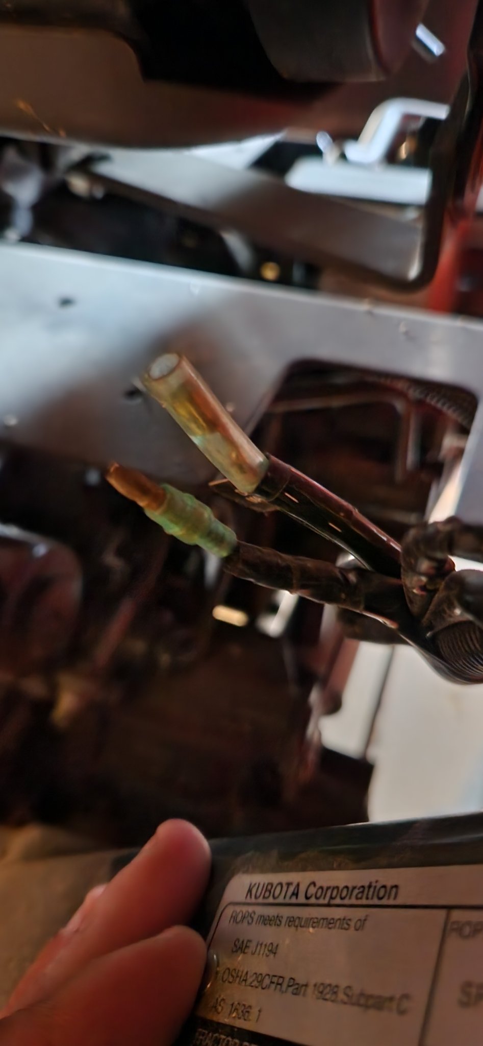

I found 2 wires under the right fender that are hot when the key is on .
I hate to snip the ends off of a brand new tractor.......and I'm sure it could be used against me on any warranty but clean secure wiring is my pet peeve and know I can make it look clean and work.

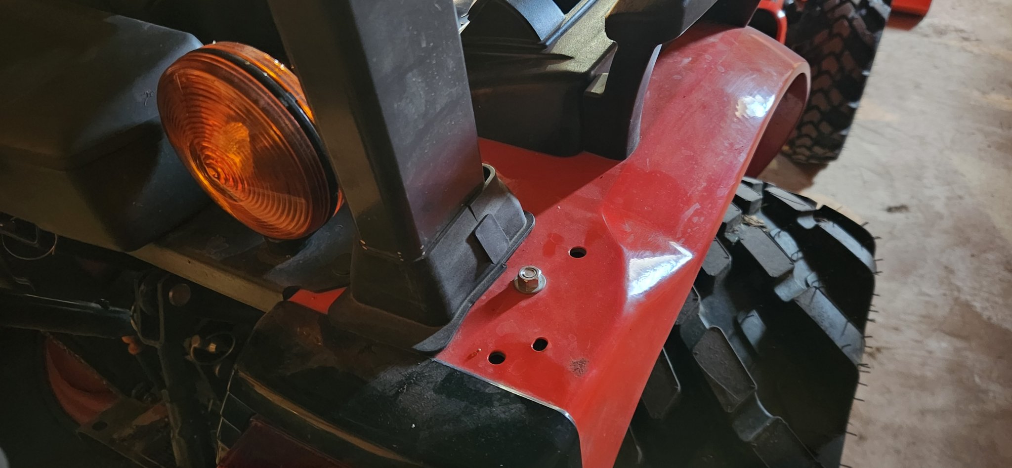

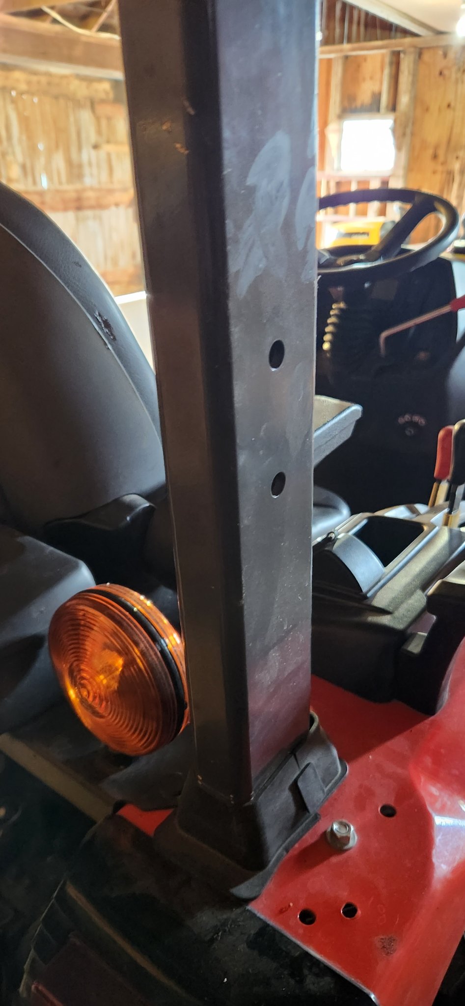

I have a couple of holes in the fender I was thinking of mounting the light and switch to, or maybe on the the side of the rops.
I just wanted some clarification.........I know enough about power and plumbing to get me in trouble.......
But I can hook 1 tractor wire to a switch and the switch to 1 light wire, then the other tractor wire to a fuse( for extra protection) and the fuse to the other light wire. Correct?

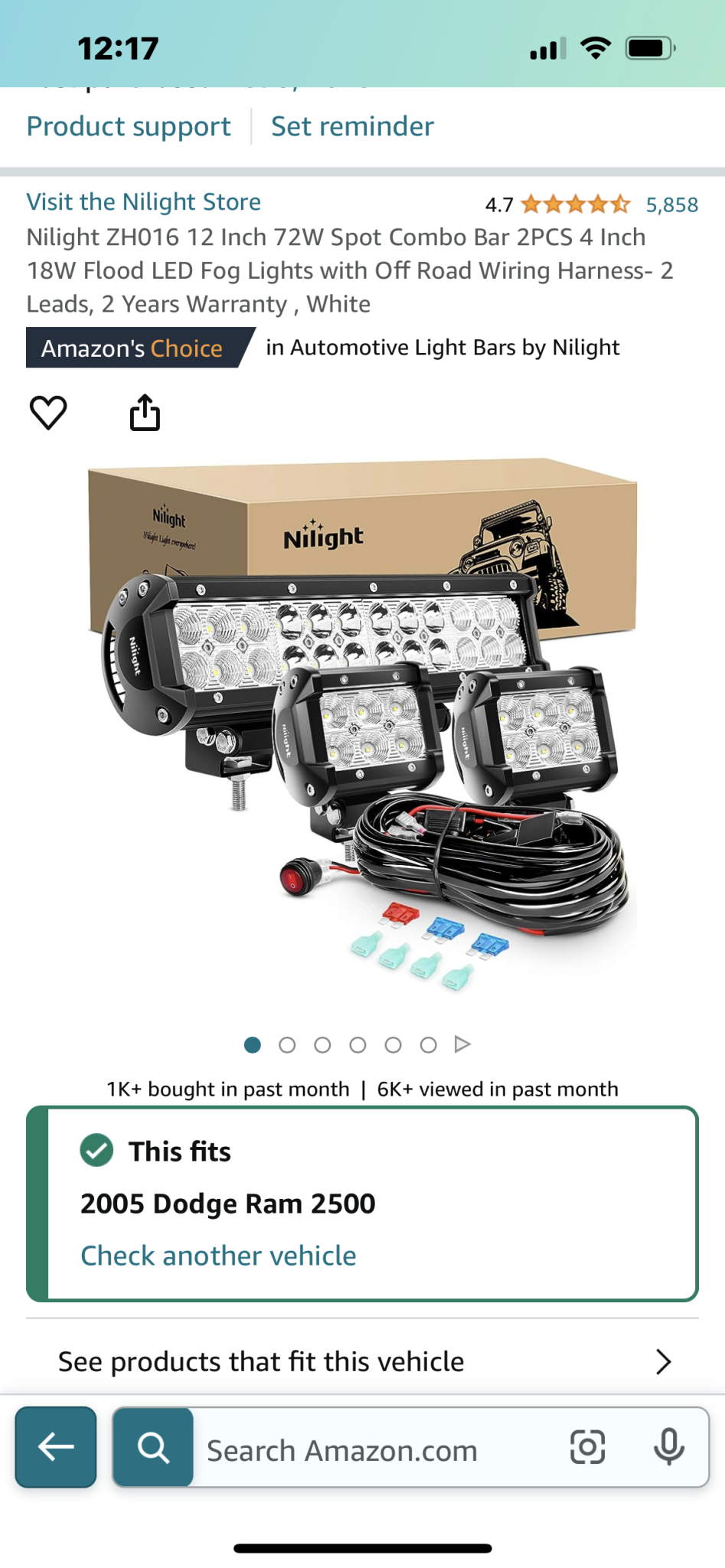

Amazon look up LED lights, I like Auxbeam just put a 15" on the front of the new Cam-am UTV for plowing.
Thanks. I'm going to try the light I'm looking at. I was just double checking if my wiring was correct and what size to use.

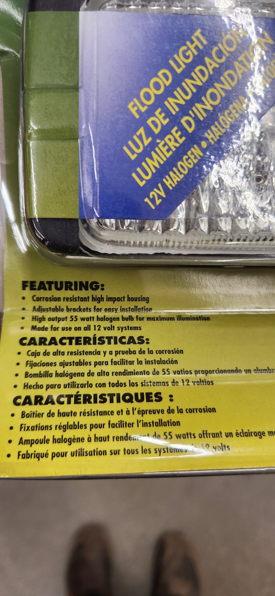

55watts / 12volts = 4.58amps
use a 5 amp fuse for single light
3rd photo shows "bullet" connectors not sure which size you need

The female bullet connector on the tractor should be the positive. I believe it is also fused in the fuse box as the work light circuit. You mention the circuit you found is hot when the key on. Do you have a a OEM work light switch (I’m thinking you don’t)? You might pull the work light fuse to confirm that is the circuit you’ve found.
I always put both the switch and fuse on the positive lead (since the chassis is ground). I like to put the fuse as close to the power source as I can to maximize the amount of the wire length the fuse protects. If indeed you’re already taping into the fused work light circuit, it wouldn’t need another (but in theory you could put a fuse in every two inches, it might not help much, but it would hurt anything either). I would not bother with a fuse on the ground line. Some light assemblies are grounded to the housing too. In which case a fuse in the ground circuit would not likely do anything.
You can match the gauge of wire you use to that of the tractor. Probably 16 maybe 18 gauge. I think the work light circuit is fused at 5 amps (35 watts).
(revised the work light fuse amperage and likely wire gauge)
You can match the gauge of wire you use to that of the tractor. Probably 16, maybe 18. I think the work light circuit is fused at 7.5 or 10 amps.

I'm sure it'll work, but I'd've gone with LED instead of a halogen. An LED will draw much less amperage for the equivalent amount of light.

Extra protection won't hurt, but the work light circuit should already be fused. You want the fuse as close to the source as possible anyway. As someone suggested, pull the work light fuse and check for voltage. That will verify it is indeed the circuit. An incandescent light doesn't care about polarity, FYI.
The fuse and switch should be in the hot lead. Personally, I don't add an extra switch. If the headlights are on, they are all on. That's a matter of preference.
You will likely be disappointed in the headlights no matter what bulb you put in. For snow, the LED pop ins may be worse because of reflection off of falling/ drifting snow. You might want to start thinking of dual color floods for the front. There are cheap and expensive versions. My preference is one that will do amber and white together. That knocks the edge off of the reflection.

Thank you. Good point about If the lights are on they're all on. I'll have to double check but I believe those wires are hot when the key is on. So the rear light would be on no matter if the main light switch is on or off. Where I work I prefer running an older skid plowing snow vs one with leds. My truck had yellow fog lamps and really liked those in snow.

odds are halogen lamp will pop a 5 amp fuse, they also generate a LOT of heat....
LEDs are the way to go, cheap, last longer, more Lumens per watt
Thank you. I didn't think of that.
Ah, I missed the part about being on with the key! Well....then that would be cause for a switch. Lol!!

There is one advantage to running halogens over LEDs for winter work. As mentioned above, halogens will create a lot of heat. The snow will melt off of the lamp. I haven't used mine in winter yet, but other lighting posts (I believe here on OTT) complain that LEDs in the front headlights won't melt the snow off of the plastic housing.
As for wiring, I'll second what others have said above. The connector you located should already be fused for a 5A work light. You can buy the bullet connectors so you won't have to cut the existing connectors on the tractor. Add a weatherproof switch on the positive lead between the bullet connector and your light. Don't forget the heat-shrink tubing and split loom to protect the wires. Lastly, crack open a cold one and bask in the glory of a job well done!
