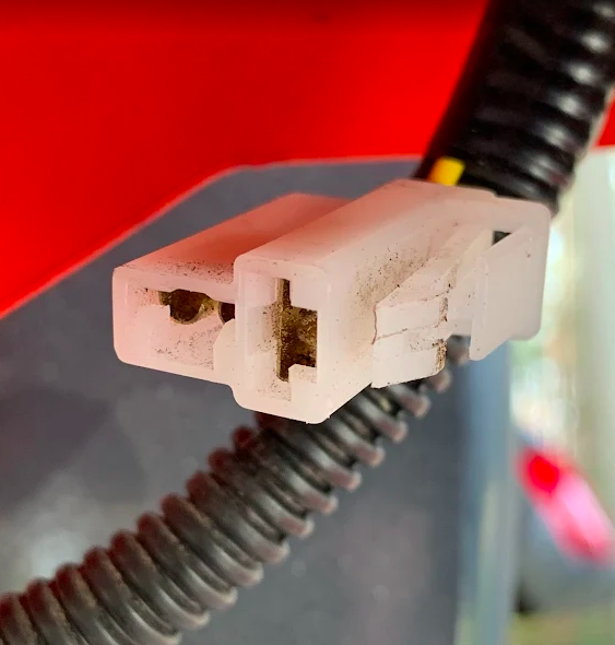

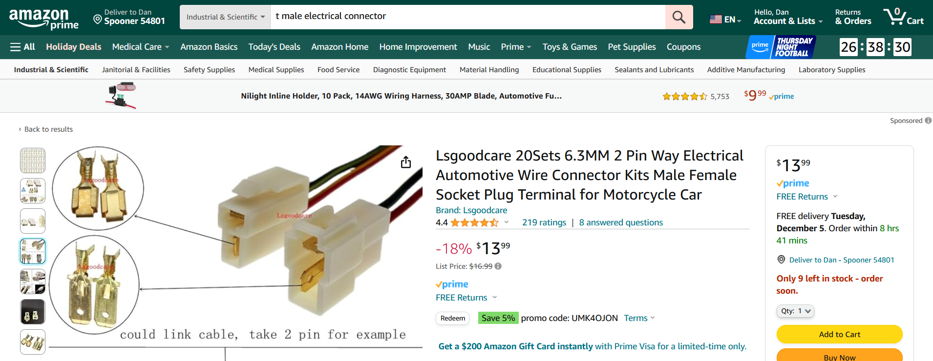

It was faster to pin a water tight automotive connector it than it was to go to the parts store. Searches yielded nothing useful. Lots that looked similar, but no measurements.
Apparently Kenwood stereos use the same plug.

Well, part of that explains it. I don't shop Chinazon. Lol. Good to know when people ask about them though. There are a ton of threads here with no real answer. Till now.

Not my tractor, it's the same plug I installed. I don't have a photo of the tractor connection. This is a fuel transfer pump power lead from a Yanmar to power the transfer pump on the drum.
I use them all over- lights on the tractor or truck, replace burnt connectors on motorcycles. Totally factory looking. Better than what is used on a lot of equipment.
