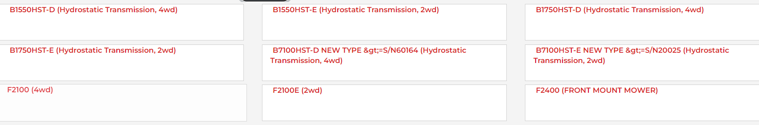

C Crowner1 New member Equipment Kubota B1750 Jun 2, 2023 2 0 1 44822 Jun 2, 2023 #1 Will a rear end from a b6200 fit in a b1750 thanks
North Idaho Wolfman Moderator Staff member Lifetime Member Equipment L3450DT-GST, Woods FEL, B7100 HSD, FEL, 60" SB, 743 Bobcat with V2203, and more Jun 9, 2013 34,383 9,613 113 Sandpoint, ID Jun 2, 2023 #2 No, they are not the same. Also DT rear ends (which kubota calls the Transmission) can be different than HST Would need to know your exact model variant. Here is an example of models that might fit it. Last edited: Jun 2, 2023
C Crowner1 New member Equipment Kubota B1750 Jun 2, 2023 2 0 1 44822 Jun 2, 2023 #3 North Idaho Wolfman said: No, they are not the same. Also DT rear ends (which kubota calls the Transmission) can be different than HST Would need to know your exact model variant. Here is an example of models that might fit it. View attachment 103980 Click to expand... Thank you for the information, the serial number plate says B1750 HSD-1 Last edited by a moderator: Jun 4, 2023
North Idaho Wolfman Moderator Staff member Lifetime Member Equipment L3450DT-GST, Woods FEL, B7100 HSD, FEL, 60" SB, 743 Bobcat with V2203, and more Jun 9, 2013 34,383 9,613 113 Sandpoint, ID Jun 4, 2023 #4 Crowner1 said: Thank you for the information, the serial number plate says B1750 HSD-1 Click to expand... The list I put up is the righty matches then.
