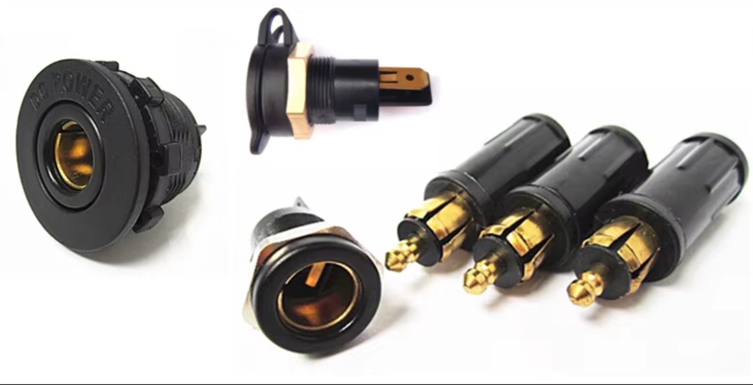

Running a heavy (fused) power wire to the rear of the tractor provides unlimited possibilities, (lights, fans, small winch, jumper cable, 12v fuel pump/bulk tank, ect)

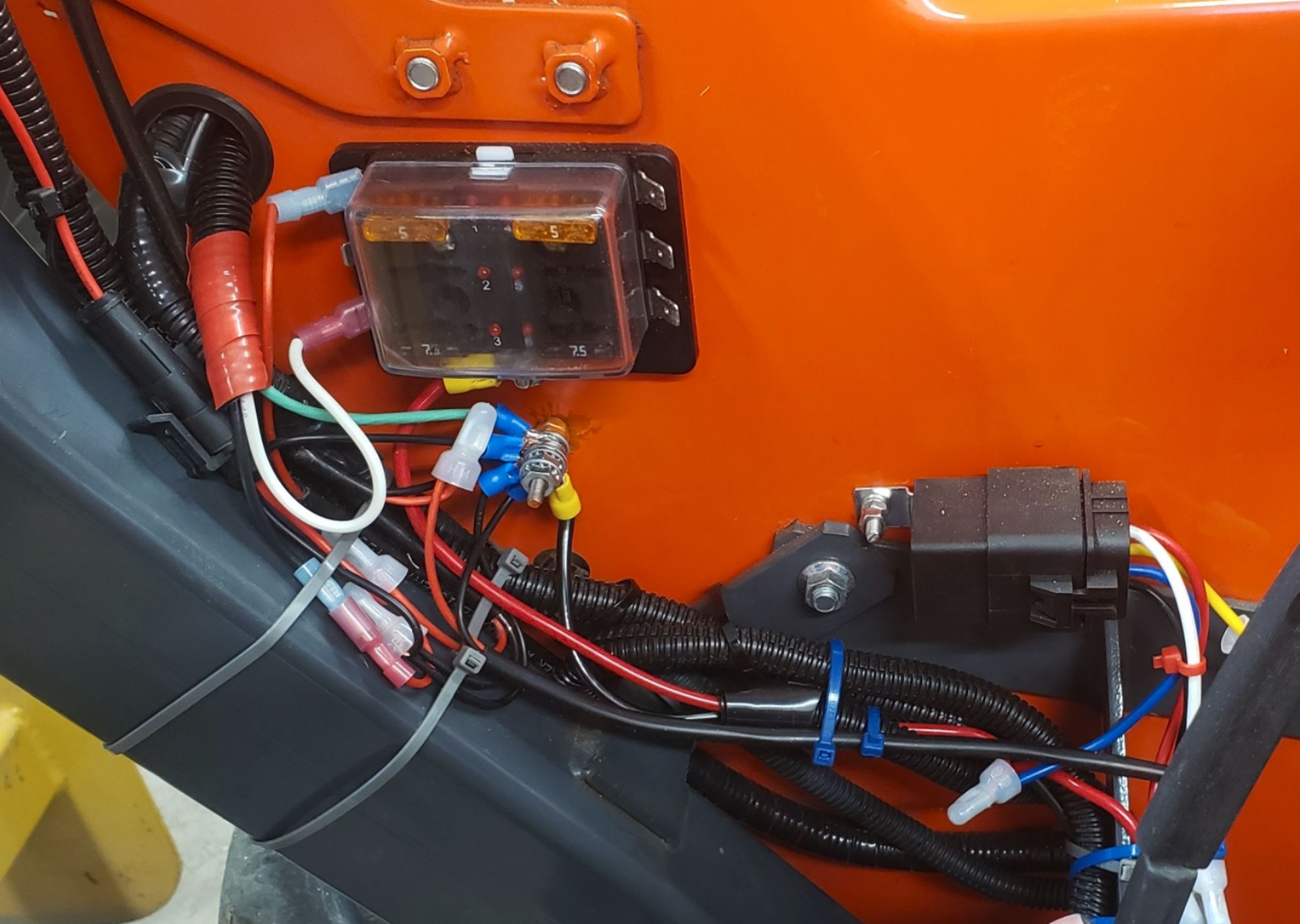

I did a similar install as i7win7, although a bit more modest. I wanted a fuse block back there that I could take different switched circuits off of. My install was for a max of 20a draw. It powers all my added led lights, snowblower chute rotation and deflection, and an automated ssqa open/closer.
The (cheap) 40a relay powers the fuse block whenever the key is on (fed from that aux light connector).
I have the very same components sitting here right now. Mine will be 40A and everything will be housed in a polycarbonate enclosure with a gauges, switchs and multiple 12v outlets on the exterior. How hard or costly would that have been for Kubota?
