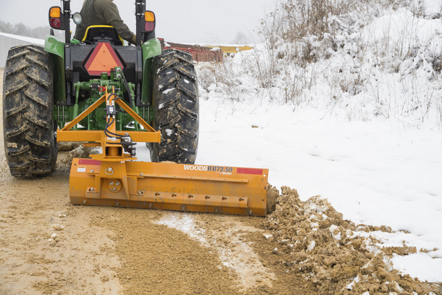

Not just angled, but offset by swinging the main beam to the side, like this blade can do.

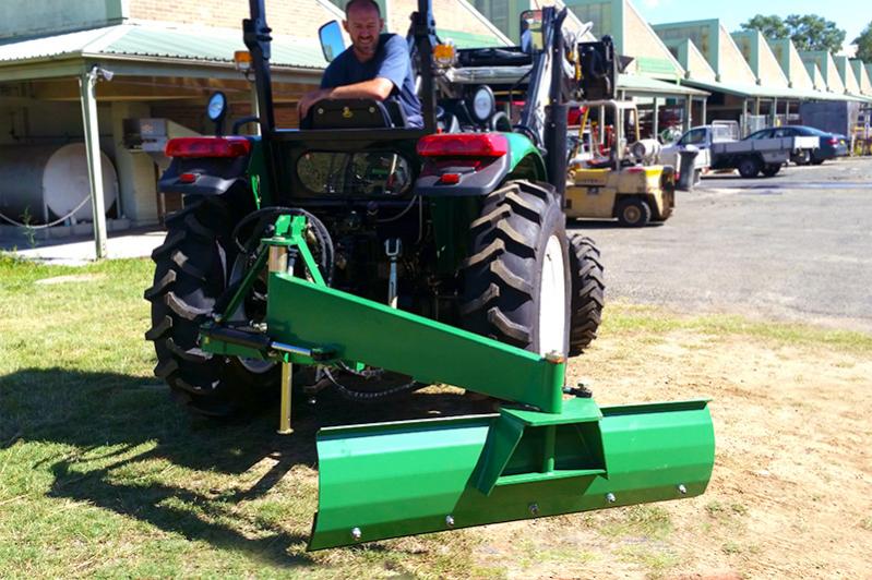

Here is an offset blade photo.
The other way to get an offset is to remount the blade to the side of the non-swinging beam.
