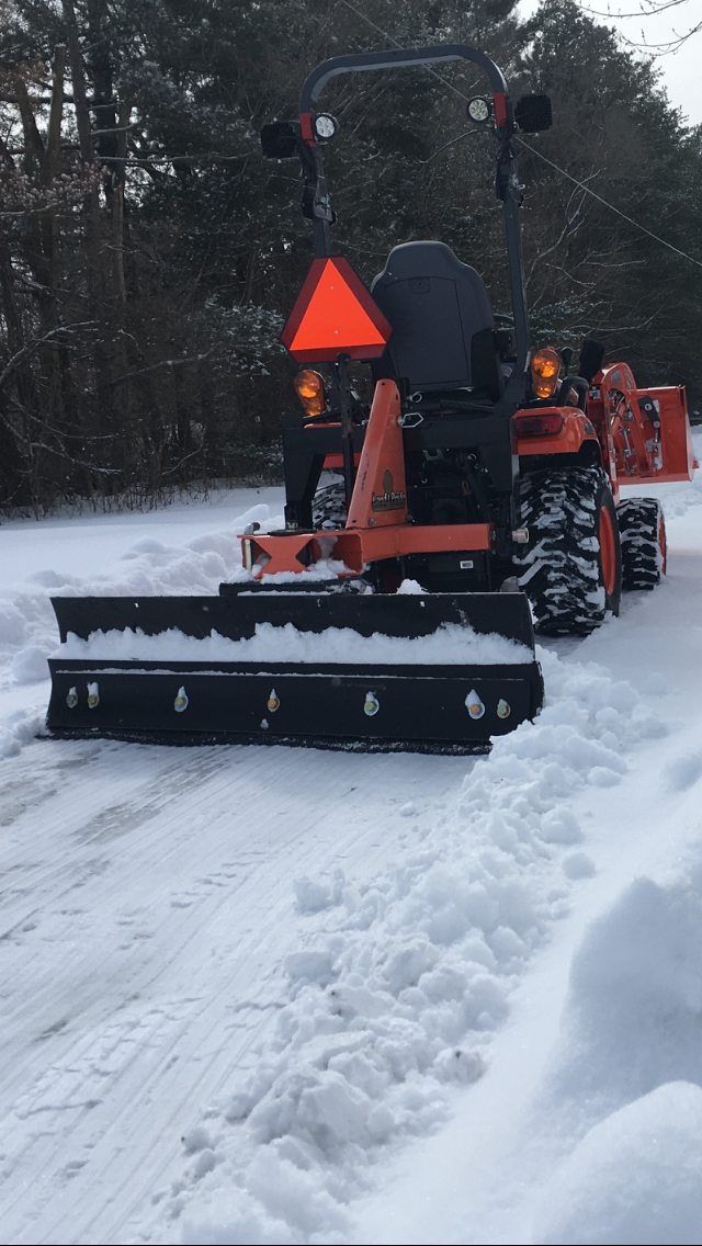

I purchased the 3/4" horse stall mat from TSC and mounted that on my rear blade to help preserve my concrete drive.. but it works great on my other gravel drive too. Sandwiched in between the blade and actual mounting plate.
You can see how it contours with the gravel drive but I had no problems with pulling the gravel with the snow.
