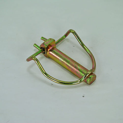

All Lynch pins are not created equal. There are the regular "dollar" pins and then there are the heavy duty pins that will bust your fingers when you latch/unlatch them.
Been there, done that, and have the T shirt. Get good heavy duty pins.
I recently learned this while buying the pins with the round rings that fold over. The guy at the parts counter told me "no". He then showed me pins that you have to squeeze to rotate the lock, they are more squarish looking. I wish I bought more of them after reading this.

They look like this, you have to squeeze them to unlock which then allows the ring to rotate
