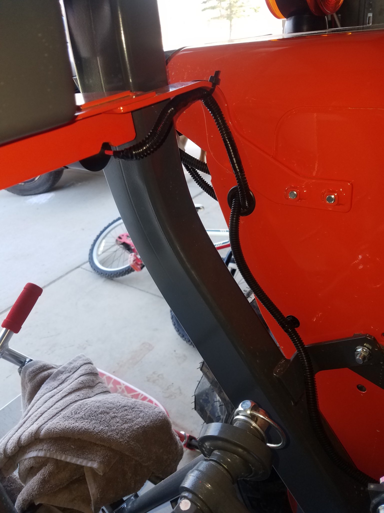

First month with the new L and made my first mod, so to speak. I added a rear 12v marine-rated power outlet for a work light and/or sprayer. The best spot for me was under the reflective device mount. I went online and got the connecter to match the factory work light plug under the fender. The connector is a 2-pin VHF/UHF power connector (looks like a T). You'll need the female one, which is confusing because it has the spades. Everything else I had laying around. With my former B, I took the time to wire a switch up to the dash and permanently affix lights to the rops, which, in retrospect, was overly complicated. With this set up I'll just stick a magnetic led light on the rops when needed which is usually only in the winter when plowing snow.
