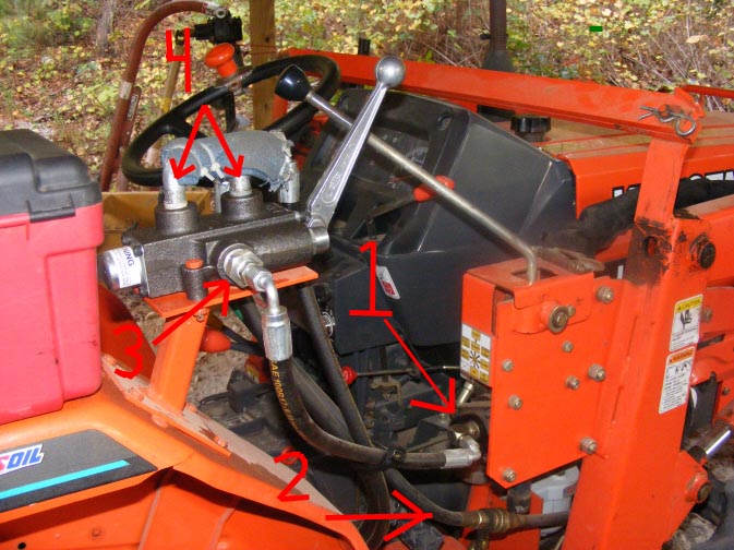

This may not help but this is what I did on my L3000. I have been using it to pull a hay rake for a couple of years now and it works great. I bought my valve at TSC and the other parts came from my friends hyd shop.
1. where the original loader input line was hooked
2. moved loader input line to the input port for new valve
3. output from new valve hooked back to loader input #1
4. lines going to rear remotes
Just have to overlook the custom rag heat shield. I had to get in the field and it was handy.

You did that without a power beyond fitting in that valve?
I unhooked the factory line that was hooked to port #1 (in the pic) which supplied fluid to the loader and simply moved it to the input side of the new valve. The output side of the new valve goes right back to port #1 on the loader control. Simply put, the fluid when not being used for the rear remotes just passes straight thru the new valve like it's not even there. The loader works same as it always did, no loss in performance in any way shape or form. Obviously when the rear remotes are used it will rob the fluid going to the loader but I don't have enough hand to operate both at the same time so again nothing suffers from performance loss.
If a person needed more remotes Northern Tool has a 6 spool valve that would let you operate 6 sets of remotes if a person had the need. This project was inspired by a few short words, "keep it simple stupid" and we did just that. It was about as simple as it could have been done. Kubota already did the hard part, all we did was tap into the system and borrow some fluid flow when needed and the rest of the time as far as the factory system knows nothing is different.
