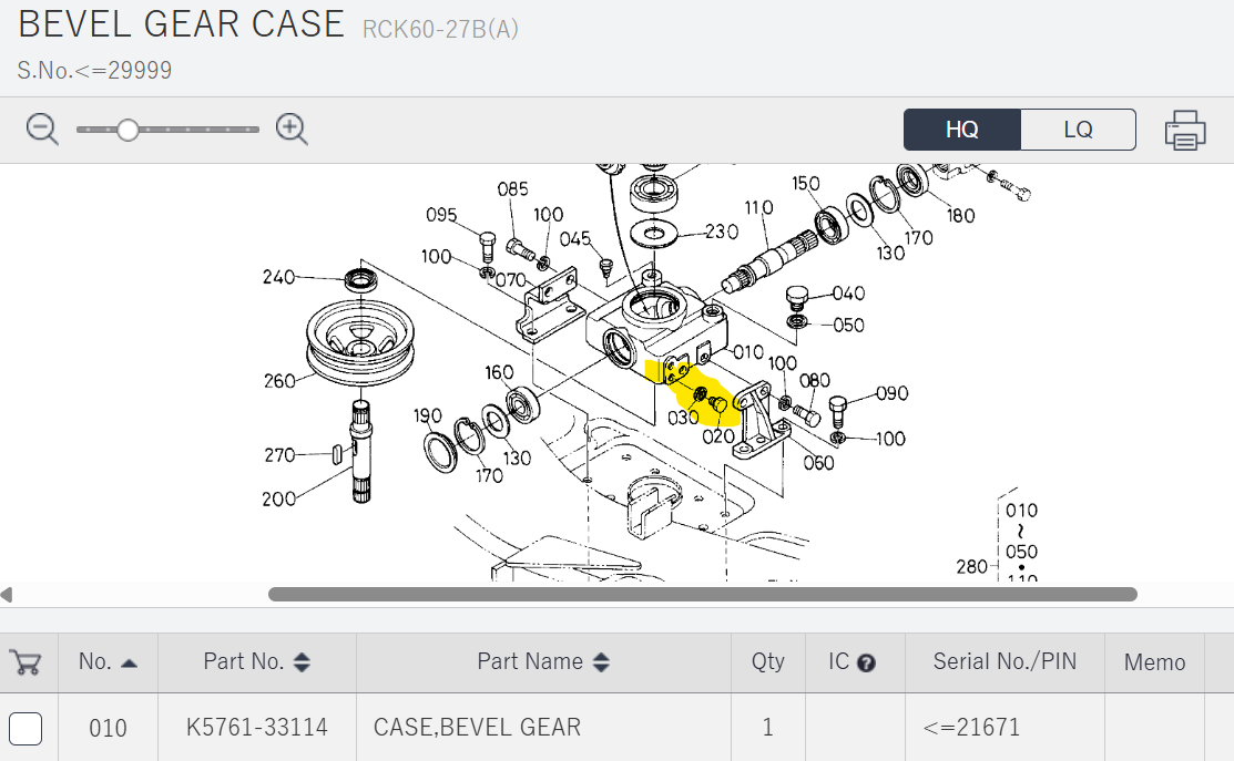

I’ve owned this mower since 2010. It’s not sounding the same. I’m thinking the gearbox needs rebuild. I has about 1/8 vertical play between the pulley and the gearbox. Problem is the gearbox is serial specific and the serial label has worn off the deck. Trying to get info from the dealers sticker on the tractor and using its serial number. But if that doesn’t work does anyone have any ideas how to figure this out? Also, does anyone know the torque for the top nut on the outer pulleys? Thanks.

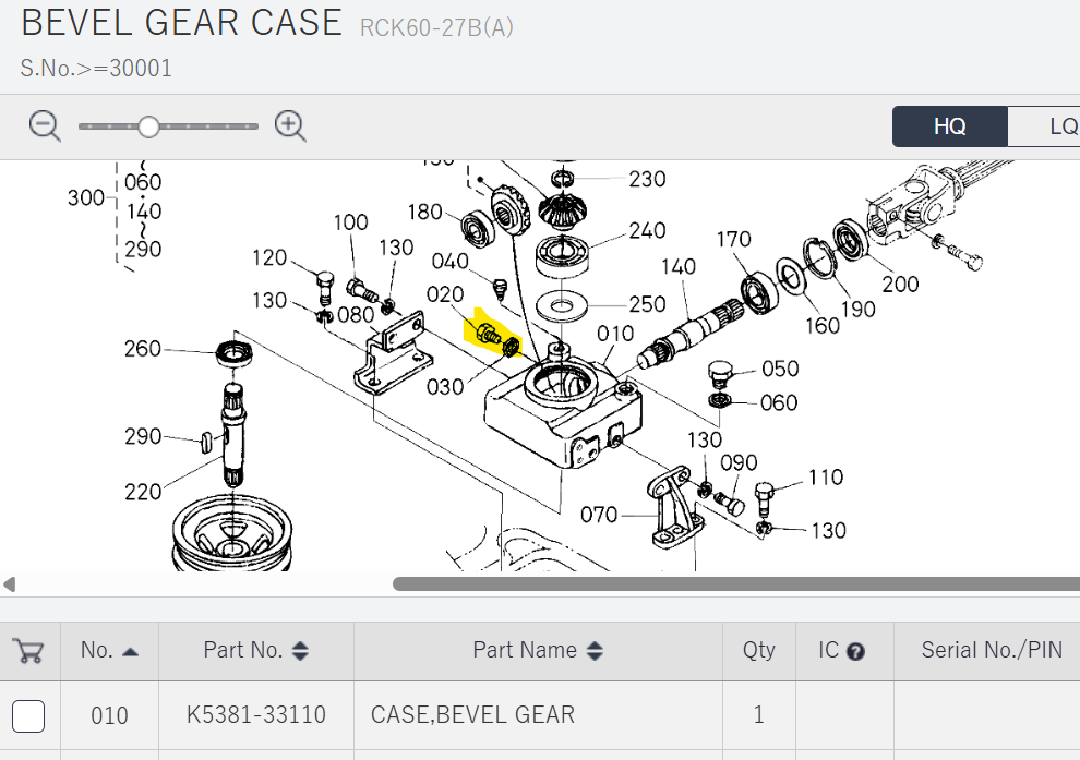

Here is how you can tell which case you have:
The drain plug changes sides.

You’re right, I did a parts comparison and found on the prints that I have the older type. The older type has a cap on the side of the gearbox which the newer type does not. Many parts have been converted over to new part numbers. Thanks for your responses.
