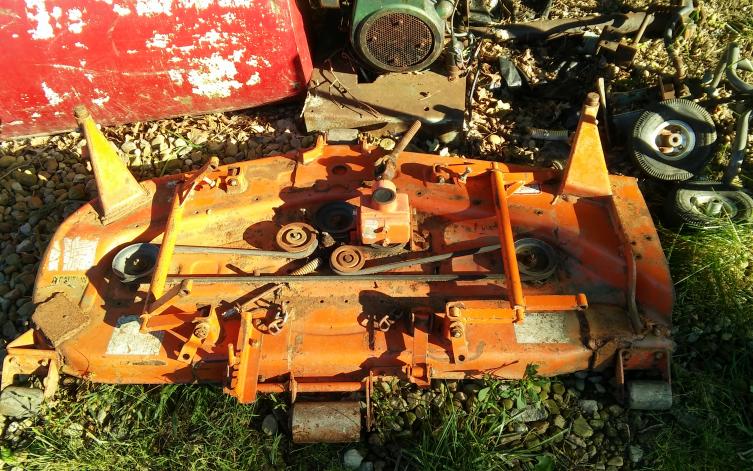

Thanks, I would like to find a gearbox for what I have. Not sure if your box would work on my deck.
