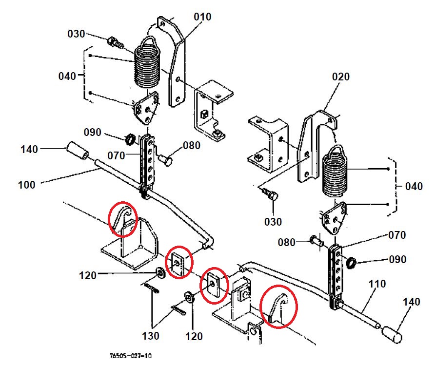

Here's a snip from the Parts List for this deck:
The U-shaped brackets near the top of the drawing are to be bolted to the tractor's frame members. The brackets circled in red are not on my deck. Looks like they should be welded to the deck shell, near the back edge of it.
I wonder if assist springs were a upgrade introduced on decks that were manufactured later than mine.
So, what's your opinion on the worth of these assist springs? Do they substantially improve the performance of the deck?
I looked up a few of the part numbers, and to me, it's cost-prohibitive to think about gathering up all these parts from a dealer. The springs alone list at $116 each! The "stays" (parts 010 and 020) are $48 each. The levers (100 and 100) are $59 each. $560 total for all the non-standard parts. Yeesh. Besides, I'd have to fabricate the welded-on brackets from scratch.
To me, at this point, this is another feature that's something to look out for on potential parts machines. [I just placed a Wanted ad in the Lancaster Farming weekly for G1800 or G1900 parts. "What have you?"] Presuming that someday I'll be looking for a new mower shell, it's not too soon to start looking for a good one to squirrel away...
Still, interested in your opinion on this. I haven't used this deck enough yet to consider how its performance could be improved by assist springs.
