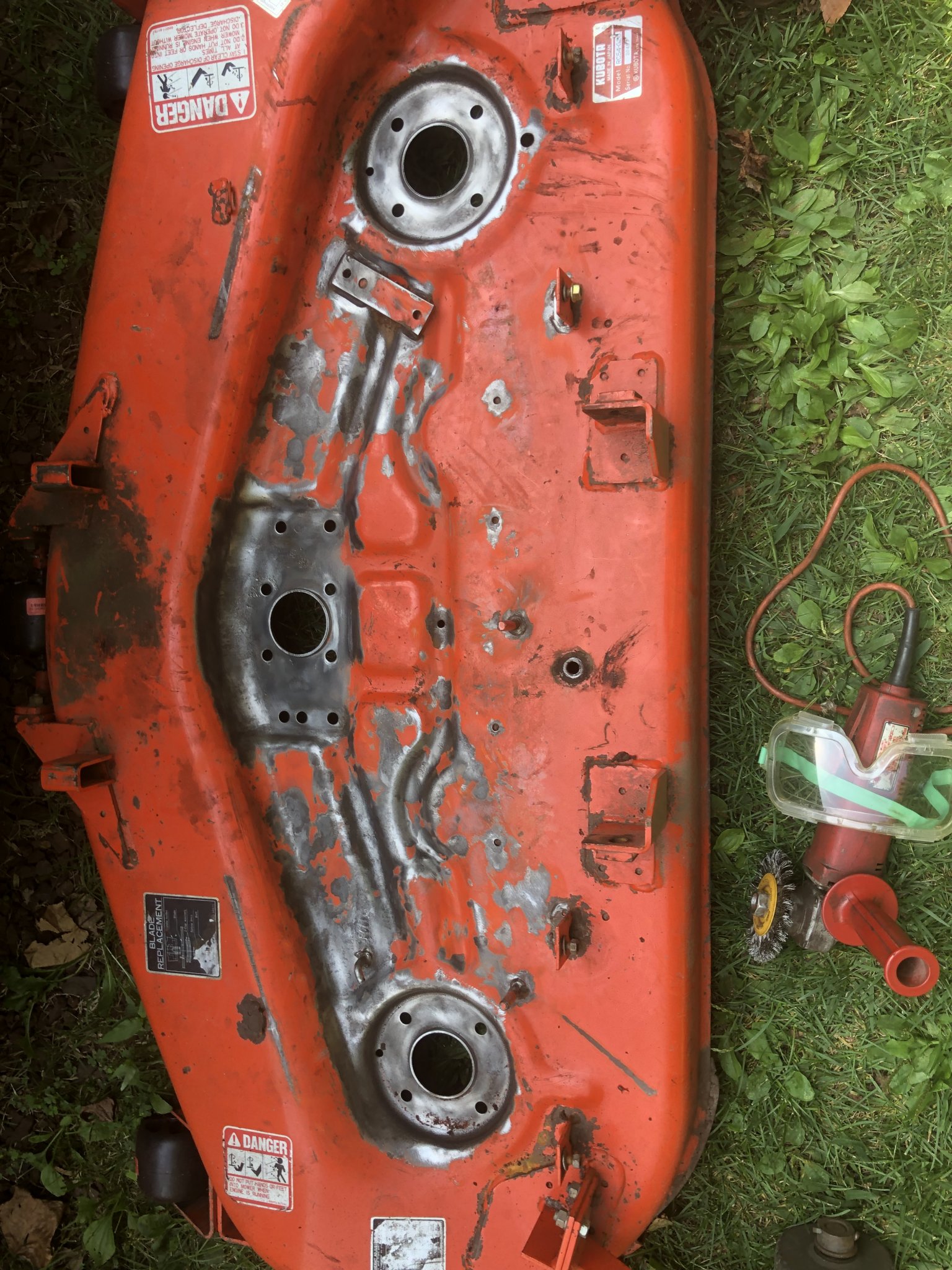

After disassembly, I cleaned up the deck shell, which had some surface rust starting under an accumulation of wet clippings. Here is the deck shell after prep, and prior to epoxy paint:

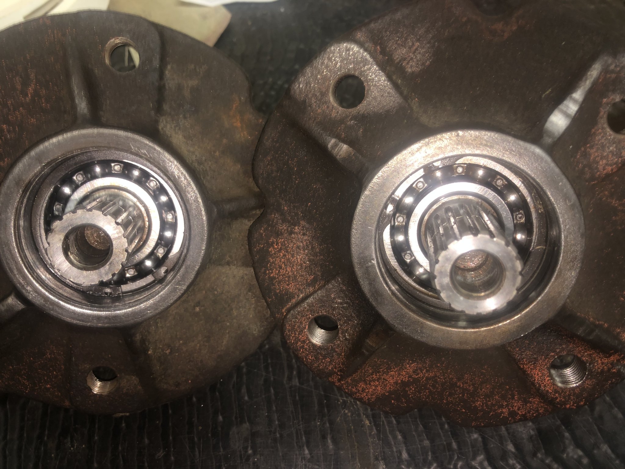

Here's a pic of the two outer spindles, showing the newly installed lower bearings from the bottom side:

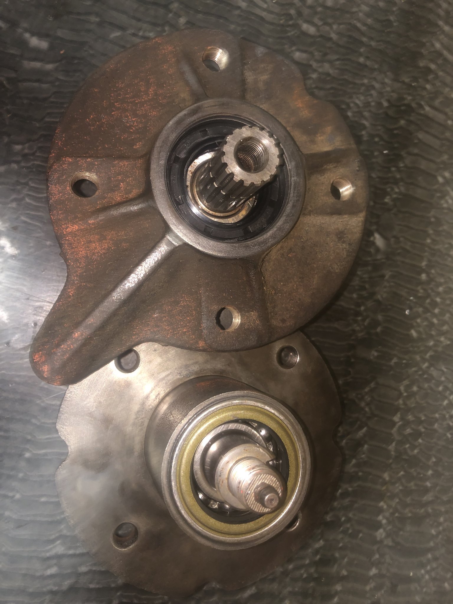

I show this pic so you can see the slight recess to receive the lower seal. It's important to get the lower seal driven in deep enough so that it is in that recess, or the blade boss will rub on it. One of the seals that I removed was incorrectly installed at the factory, and it was quite torn up by the blade boss. I used PVC couplers as a cheapie bearing and seal drivers. The other thing I did is toss the cleaned up spindles in the deep freeze overnight. Before installing them on the spindles, I put the bearings in a 200F oven for a half-hour. They dropped right into place, just a light drive to seat them.
Here are the outer spindles with seals installed. I bedded them in a tiny bit of Ultra Black silicone sealant (between the outer edge of the seal and the housing):
