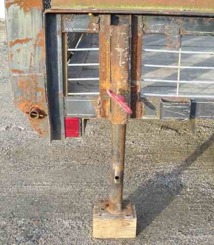

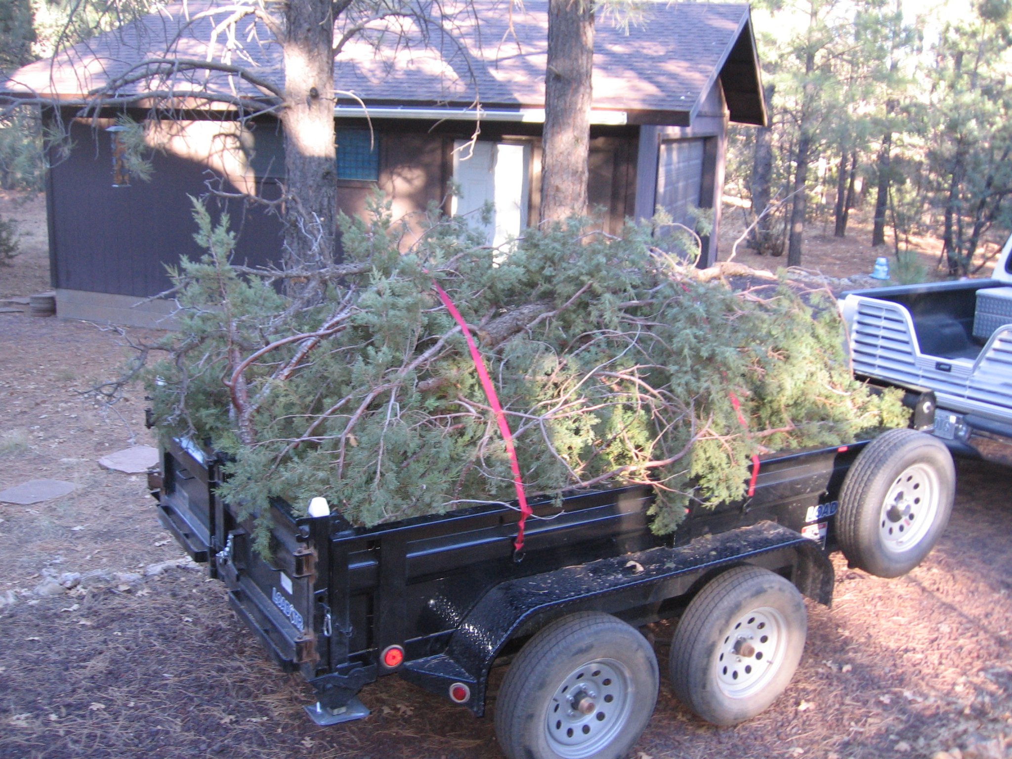

My dump trailer has drop down jacks on the rear.
(expand the 2nd pic to see jacks)
