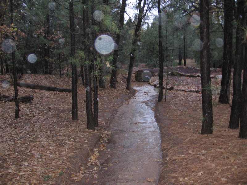

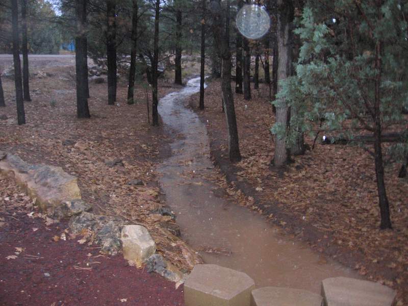

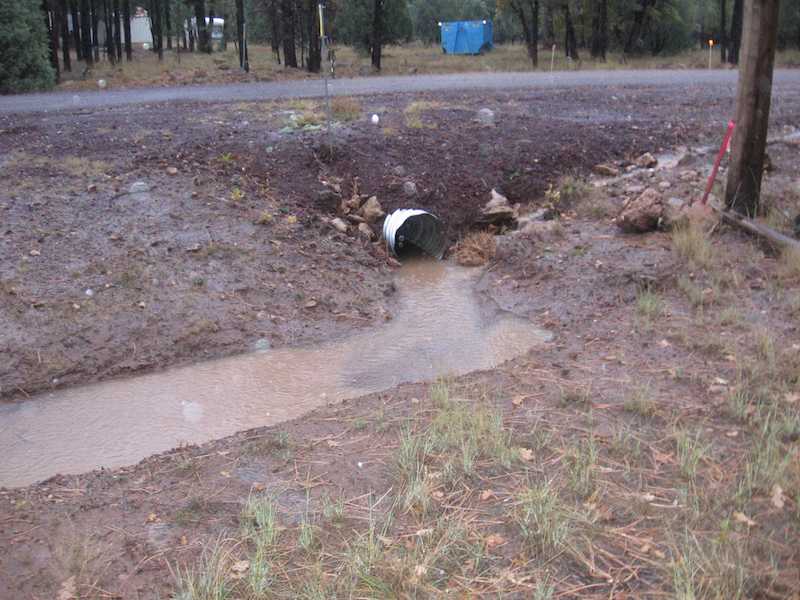

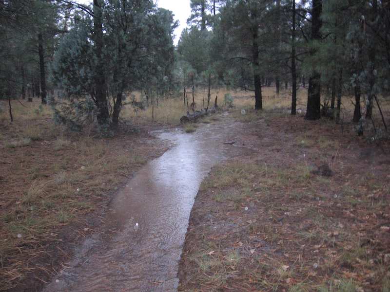

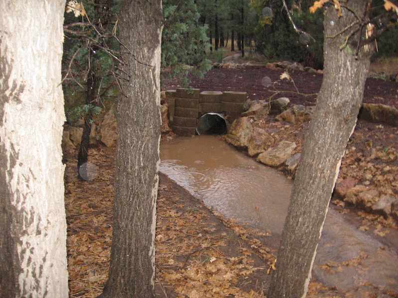

85Hokie wanted some action shots- not a big rain, but enough to get the idea.
1st pic is the county culvert that started this whole mess, 2nd is my watercourse from that culvert to the driveway, 3rd my culvert under the raised roadbed.

These pics show the watercourse from my culvert out to the end of the watercourse where the water can spread out & disperse.

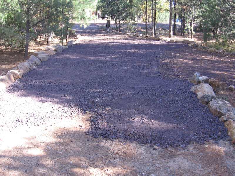

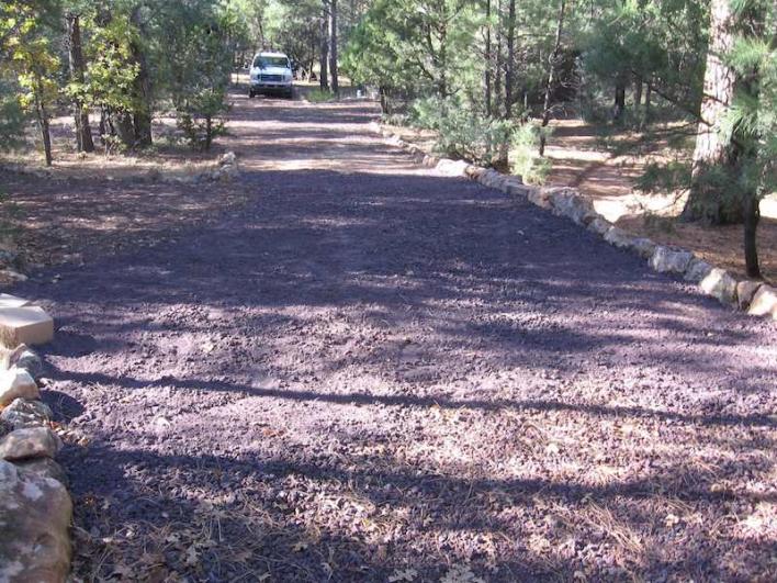

I finally picked up some more cinders & finished the driveway. I brought in another 2.67 tons, bringing the total tonnage to just shy of 294 tons.
Who says you can't do big projects with a small tractor?:D

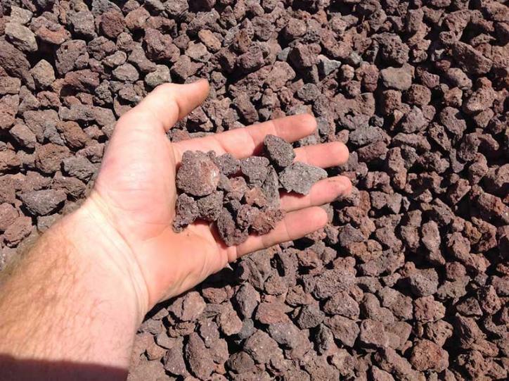

Thanks! the cinders are just that- volcanic cinders from the Flagstaff area. They are relatively light weight & cheap ($5-$7/ton) provide amazing traction, and lock together like you wouldn't believe. Look good. too.
Like this:

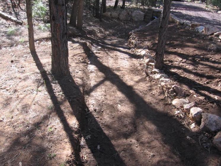

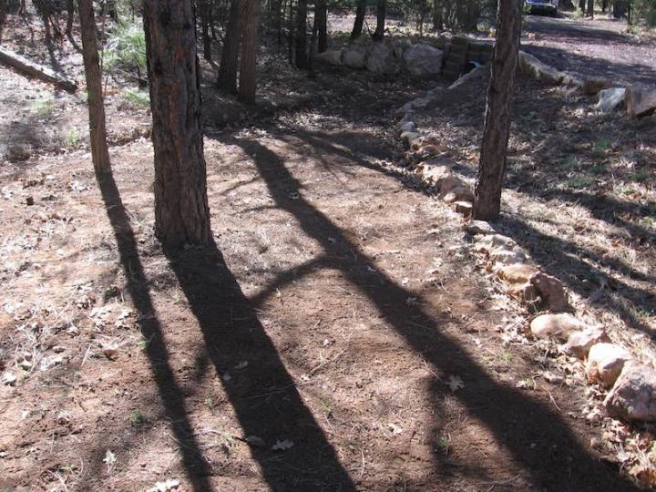

This past week I did a little more on my raised driveway project. Heavy rains revealed that runoff from the county road was running against the upstream bank of the roadbed. Not a lot, but over years it might cause some erosion problems.
I lined the bottom of the bank with some rock, then cut a channel parallel to the bank to carry runoff to the existing water course that goes through the culvert. Pics are a little hard to see, (lots of shade from trees) but the 1st shows the before & the 2nd shows the channel, about an inch deep next to the bank, and about 5" deep on the other side. That should be enough to start the runoff cutting a new watercourse away from the bank.

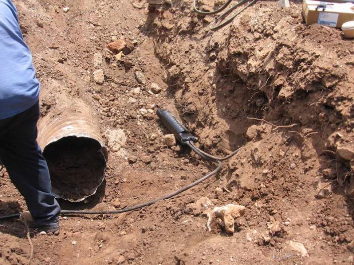

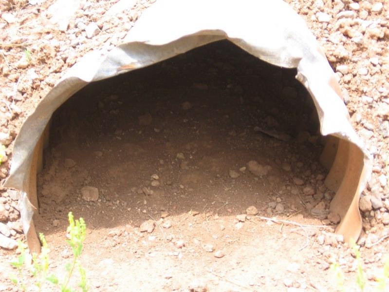

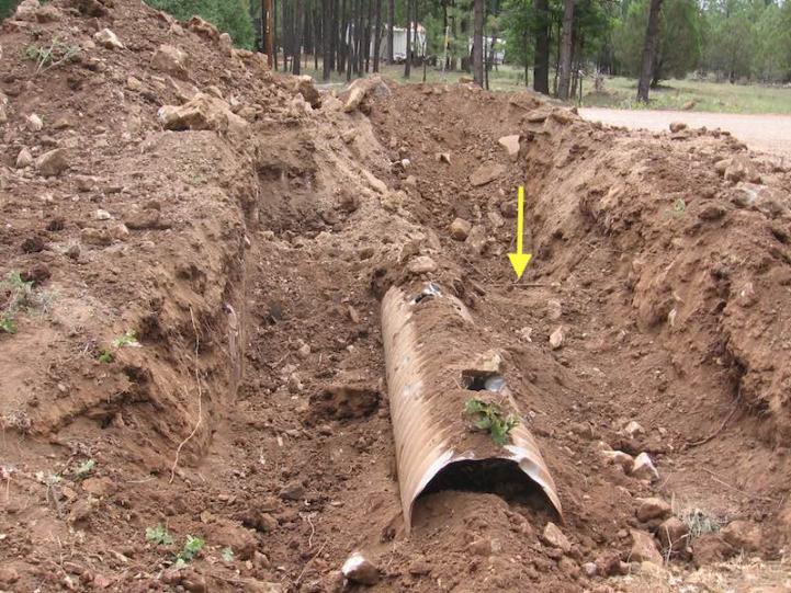

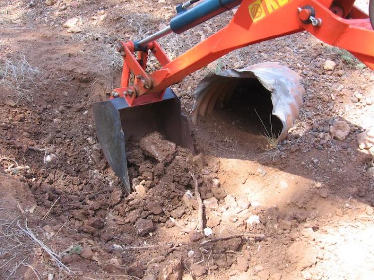

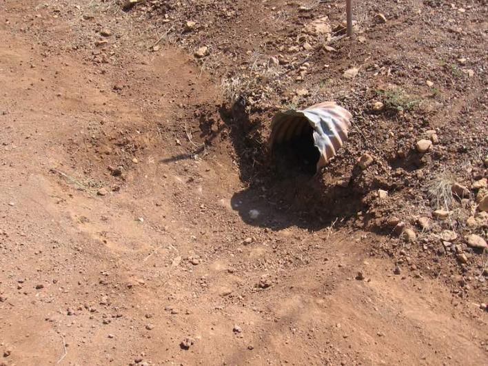

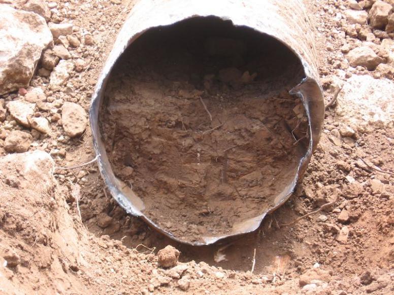

The drama continues. The county culvert that dumps runoff onto my property has never flowed freely, causing water to back up & flood on the opposite side of the road, then washout the road in front of my place, four times in 30 years. After begging the county for help, (fat chance) I finally figured out that the phone company, 30+ years ago, trenched through the culvert, and laid a phone cable in it, creating a "snare" to catch stuff & plug the culvert. (Tell me that crew of morons couldn't tell they were trenching through a 16" steel culvert.:mad:)
The county finally agreed there was a problem, (and a common one in Coconino county) and this is their solution. They dug up the offending area, cut off about 11' of culvert, had the phone company re-route the cable underneath, spliced another piece of culvert on, did not clear the sand/gravel/clay/rocks in the old section, and buried it. ("The obstruction will wash out naturally.") They promised to come back & clear the opposite end of the culvert of dirt so that only water will go in the culvert, but never came back after almost a year of prompting. I took my little backhoe & cleared some of the dirt away away from the input end, and shoveled/chiseled/hoed about 5' of the culvert clear, and we will see how long (if at all) it takes to wash the pipe clear. I have a feeling that earth will look like the last pic before that culvert is clear.
1st pic shows cable through culvert, 2nd, the cut off culvert full of crap as buried, 3rd, re-routing the cable, 4th, the input side side with dirt halfway up.

1st pic is the new output end of the culvert; 2nd, me clearing some dirt away from the input end; 3rd the new "well"; 4th, what earth will look like by the time the culvert washes clear.

Not suprising that the cheap AZ county wouldn't just dig it up and put a new culvert in.
And your probably right, it will never "wash out" without some serious help!

The local county road crew said that in Flagstaff, they have a couple decommissioned fire trucks they use for blasting culverts clean, but not in our rural area.
