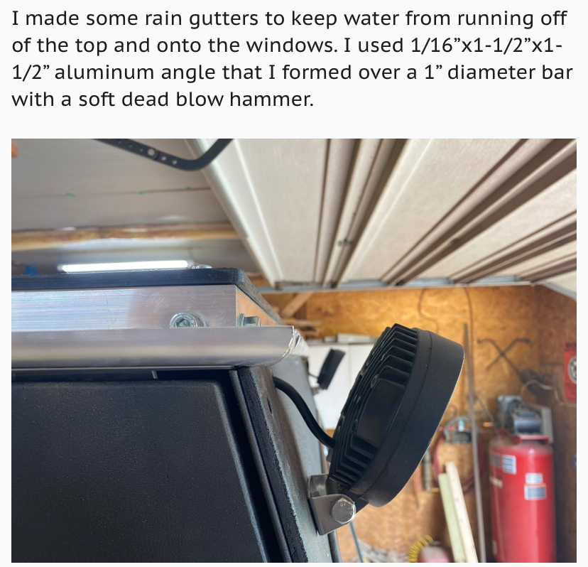

LX2610 (cab model) with a BH77 'hoe. Work very well together. Problem is, here in Oregon, it rains quite often. When sitting on the seat for the backhoe, any little bit of rain runs off the cab roof and down my back. OK, I can wear a rain jacket, but then it runs off the jacket, down the seat back, and I now have a wet, ummm, seat. Anyone fabbed a gutter/diverter/something to direct moisture off to the side of the operator station? Ideas? Not adverse to drilling holes in the cab to rivet something on.

How about running a thick bead of RTV silicone across the top rear edge of the roof? Forces the water to go off the sides rather than off the back.
