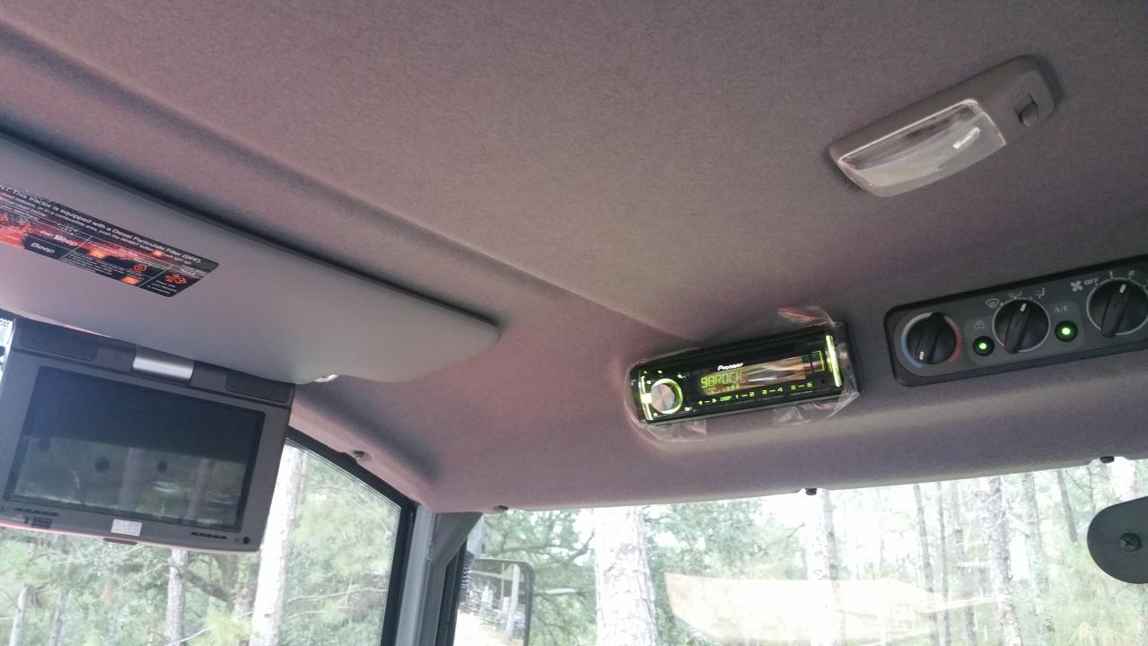

Some customizing I thought may be of interest, added a radio, it was fun trying to find the wires, they were taped in the middle of the headliner so had to drop one side to find them, the hook up was strait forward and easy to figure out the wires, listing them below if anyone else needs them since most I found listed did not apply to my tractor, beats the dealer and the 250 they wanted.
Also added a camera with infrared for the rear and monitor so I would not have to constantly look back on certain tasks. I will be adding a front camera as well once I get time next week, and if I get bored I can always watch a dvd.
Radio Wiring for M7060, M6060 and a few with Ultra Grand Cab.
Red (supposedly) constant hot not on mine anyway,
Blue/ Yellow stripe switched hot with ignition
Black is Common
White Left speaker positive
White/ Black stripe left speaker neg.
Yellow Right speaker positive
Yellow/ Black stripe Right speaker neg.
added a picture for tractor porn,
