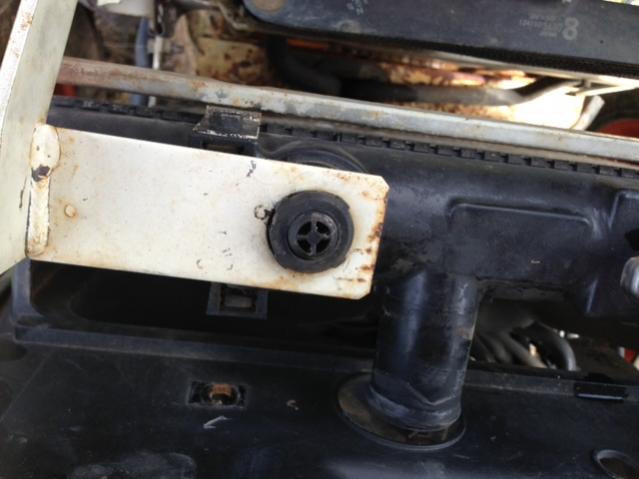

I am new at working on this tractor and trying to learn as I go. I have a radiator leak and want to remove it. I was able to un-clamp the hoses and remove the bolts on the fan guard. The only think holding the radiator in are two connection points on the top and bottom. These are a plastic center with a rubber gasket around them. I do not see any bolts and have no idea how to remove these to pull the radiator out. Please help! thanks!

The plastic part on the tank is swelled at the bottom so it might help to give it a shot of wd40 just to make it slip out better but a good tug and they should pop out.
