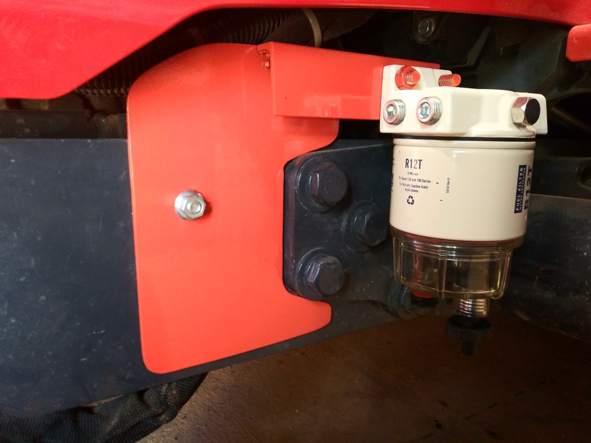

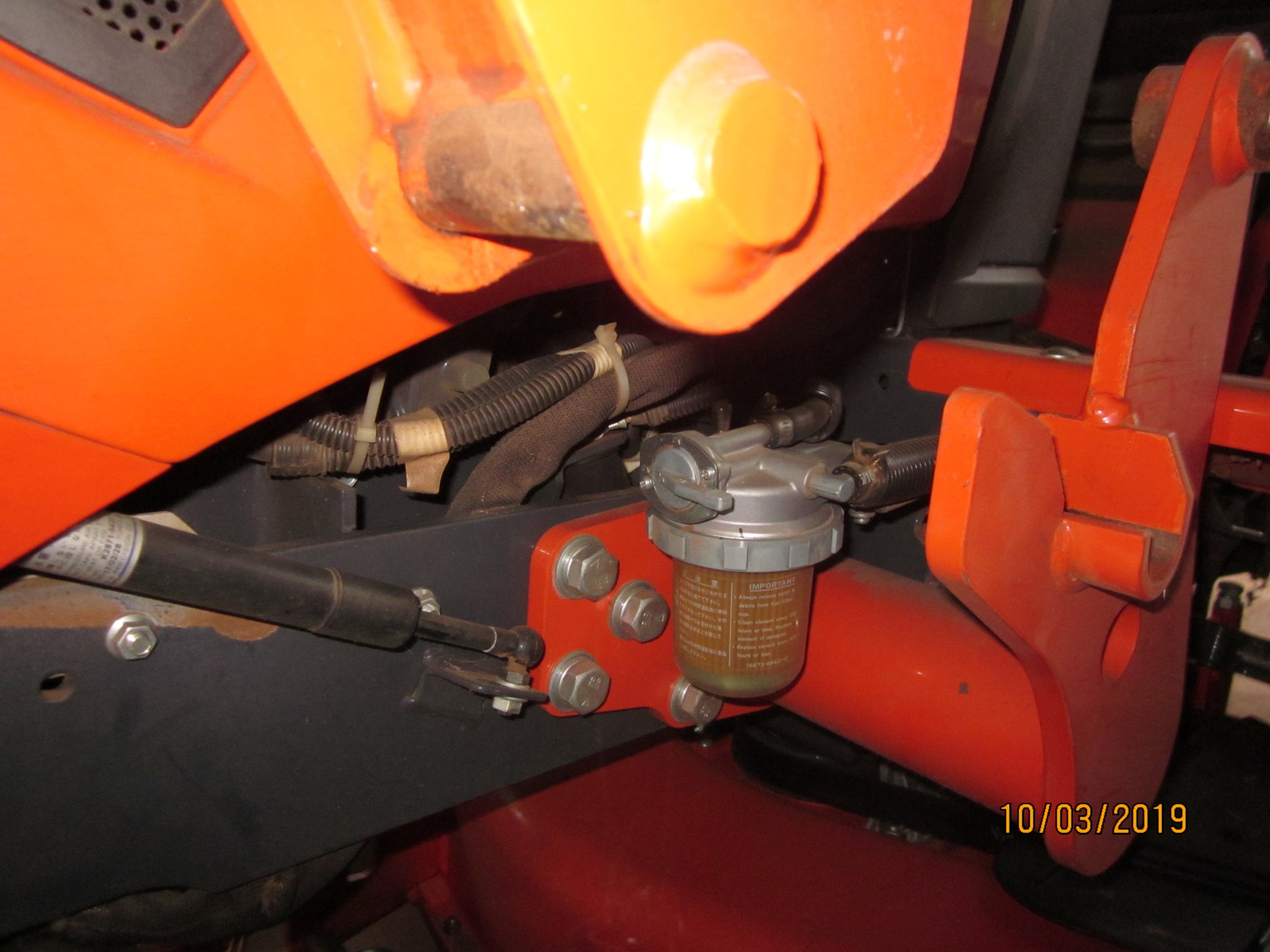

Here is what I did - as many have done.....Tank, Racor, Pump, Plastic filter, injector......
