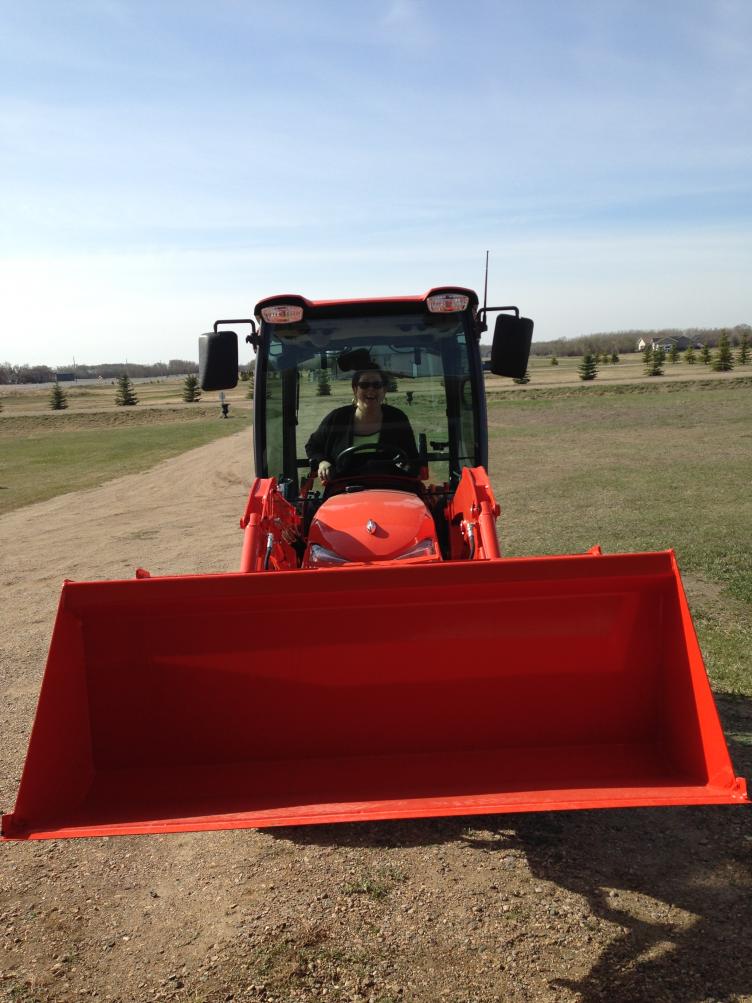

Hi All, purchased B2650HSDC three weeks ago and using it lots. One thing it did not have was loader and I really wanted one so I had to add to purchase price. The loader has had lots of use moved about 12 bucket loads or more of broken up cement. Glad I had it. I will be making a spill gaurd as I rolled a piece of cement of and damaged headlight and hood. All good though. Had R4 tires and they are good for the all around job. Thought about turfs but then would likely not work as well all round even though I have 4 acres of grass. With R4 tires wont have to have two sets as feel with turfs would hav e to change back and forth. Anyway it is great with the cab and A/C etc. :D:D:D
See if this works. I uploaded a picture of tractor and my lovely wife in it. See the smile.:p:):D
