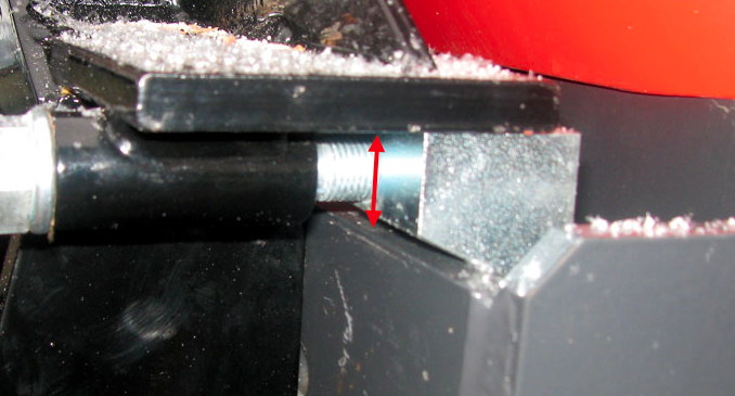

Also is sounds simple, but when you attach the front sub hitch, there are two knobs with angle lift blocks that can slightly lift each side, but they also pull the hitch right or left which can make the mount sag one side or another. Another simple thing is to look and make sure you don't have s chunk of gravel between the subframe and QD shoe which could can't it sideways.

Here is where the adjustments were made on my snowblower:
He said loosen the 3 bolts a bit and shift the blower up or down.
Hope you are doing well with yours. We have no snow and none on the horizon in the next week. :(

Good to know. I looked at those bolts (mine are currently set even) with brief temptation but opted to verify if the problem was the same with the push blade first. Turns out Blade is same so it seems it is related to the combination of quickhitch (ensuring it is tightened evenly from side to side to minimize uneven height), tire pressure (even) and implement adjustments like you just mentioned. I'll have to look closer to the blade to see if I can find a similar way to adjust and if I can do both the snow blower and blade I'll probably adjust accordingly.
