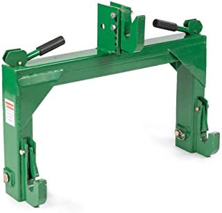

The center hook only works with attachments made for quick attach, which when I got mine, not many were, so that needed to be removed and have to use a flip over loop like this.
So before buying one, check to make sure the one you buy has a removable hook.

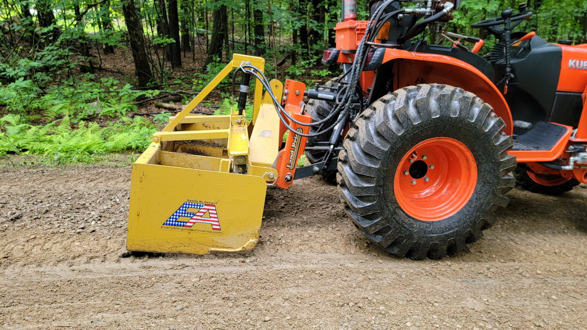

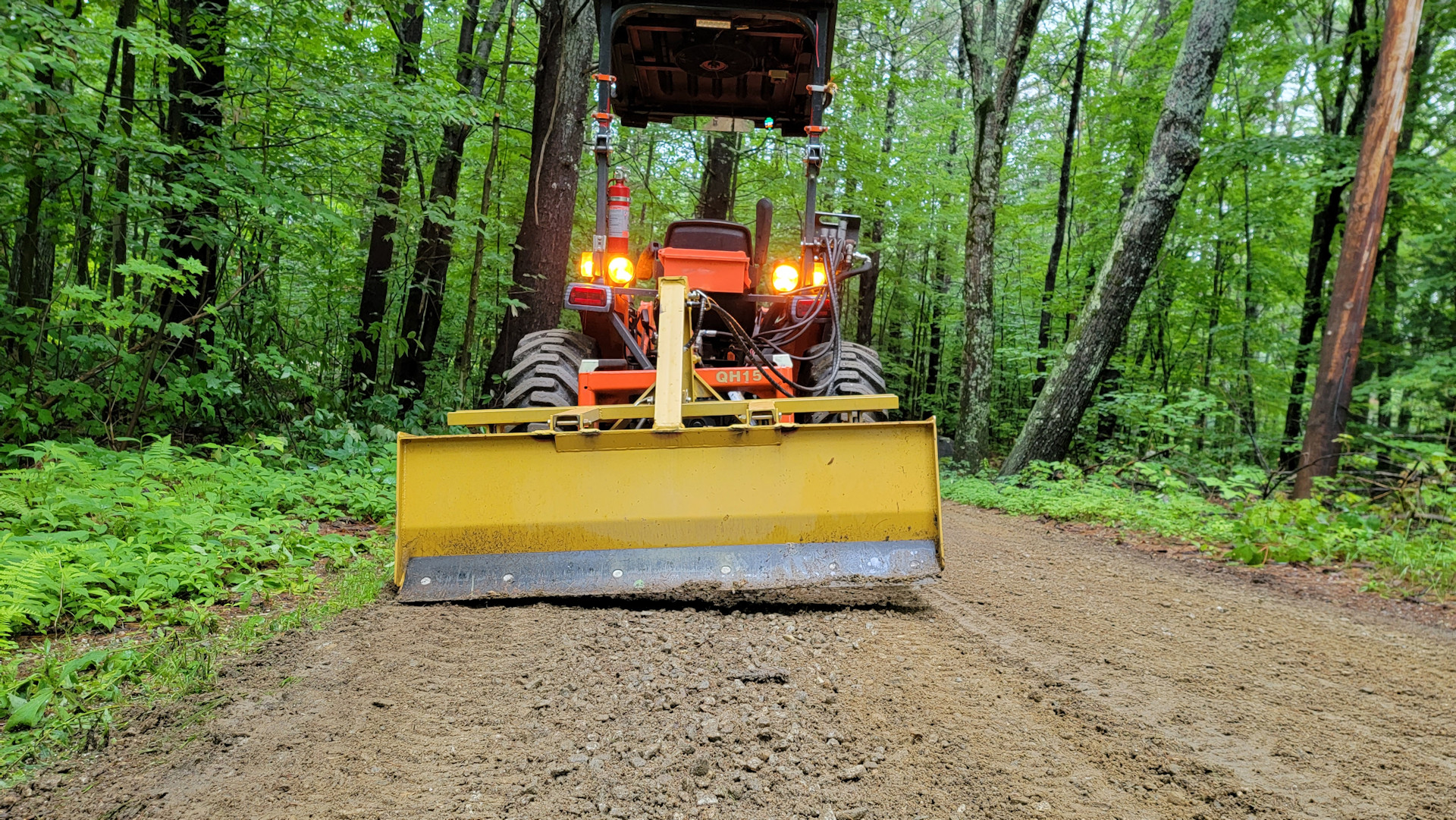

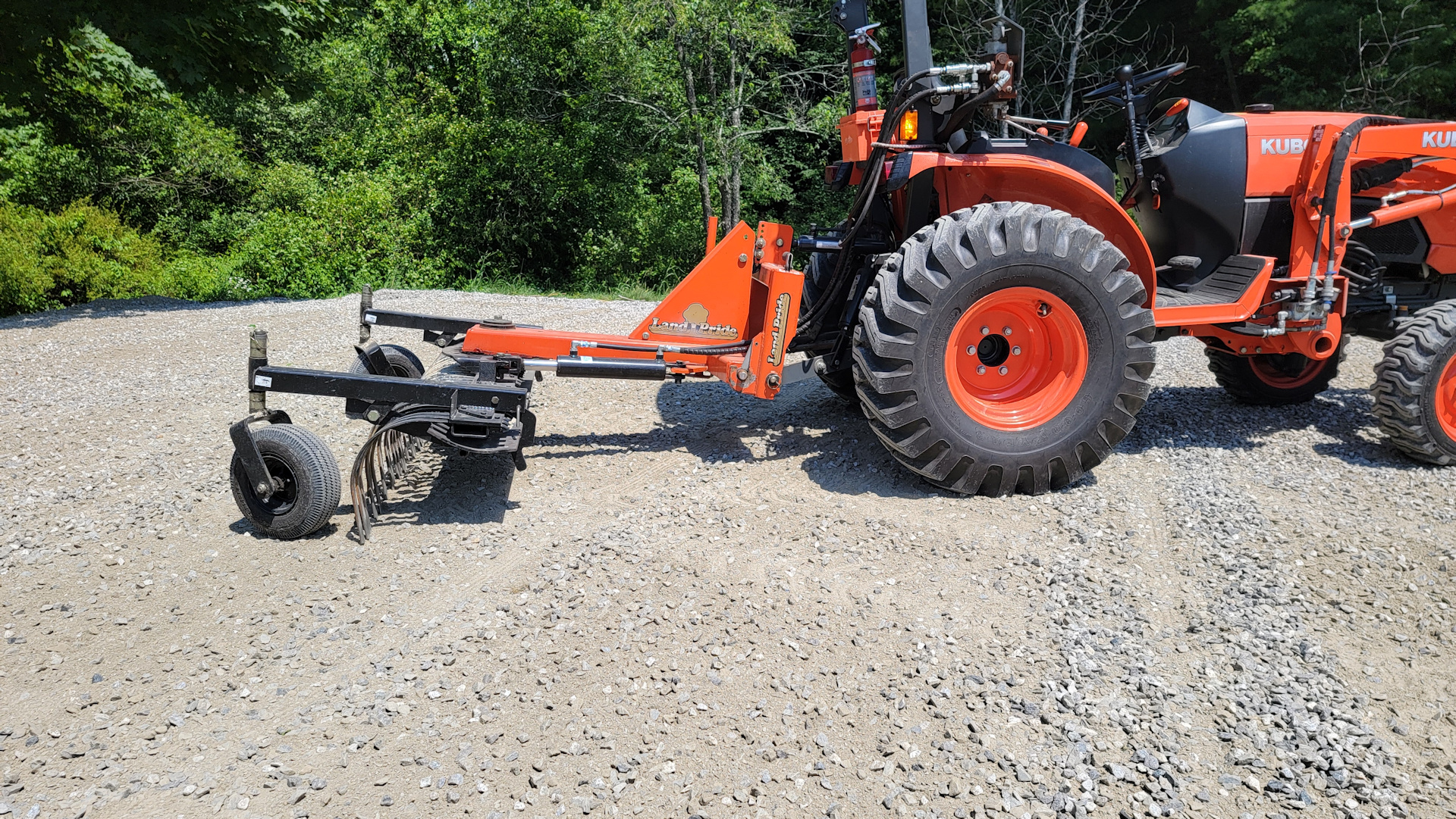

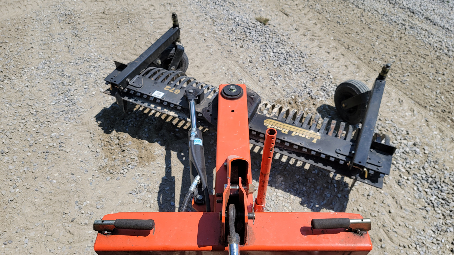

T&T (and 3rd) combined with QH is really hard to beat.
Building/maintaining a road - Cut edges on-the-fly, build a crown on-the-fly, switch from crown to slope and back again on-the-fly (top and tilt and angle if you have it).
Grading lawns etc, with gauge wheels, a rake or blade will have an infinitely adjustable cut angle within that range. Using the top link you can grade up over little hills etc (like a septic system) without leaving in the valleys and scalping the tops.
Mowing/backing - Up or down a steep bank the top link will give you a lot of flexibility.
Hooking up the attachment on an uneven surface or un-level plane to the 3pt arms, no problem (top and tilt depending) NEVER LEAVE THE SEAT!
Loading the trailer - (top) no more dragging the implement on the ground. There are tons of times when loading and operating that the T&T provided for added clearance needed to maneuver around something.
I use all 3 of my QH daily and rear remotes constantly so I could go on and on.
WAY faster in every respect for sure but more importantly it allow for a higher quality job.

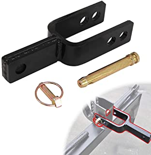

I have an Amazon replacement top hook to allow the top hook to work on my bush hog, a common problem with the HF QH. I use the above-noted U adaptor on my Fontier back blade. The top hook would not work. I also need a pair of those ~ $30 pin covering things for the back blade because my dual bushings I use on everything else to convert the Cat 1 pins to Cat 3 for the QH (just move them from implement to implement, A LOT cheaper than those $30 one that permanently stay on each implement). Only about $4 at TSC. The pins on the back blade are too short though, to put a pin in the hole at the end of the lift pins to keep the bushings from sliding off.
