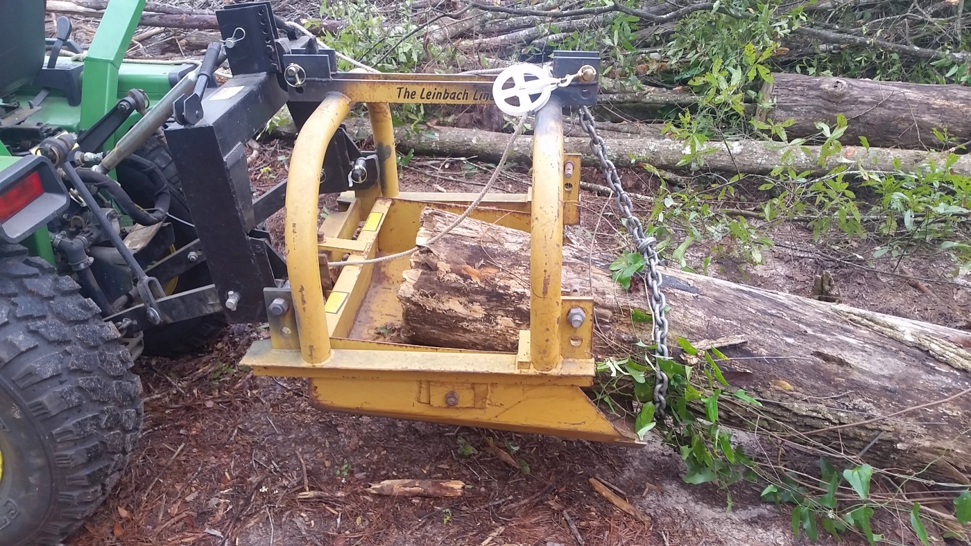

My old dirt scoop had tabs forward but too low so I welded new tabs on for the top hook.
Pretty much everything I own had to be modified one way or another to use the quick hitch on. After that it was all easy peasy.

Dirt scoops make great log skidding implements. See above pic.
Three point scoops are also much better for excavation with small tractors than are FELS.
Thousands upon thousands of farm ponds have been made with 9/2/8N Fords and three point scoops. Try doing such things with a small tractor/FEL.
