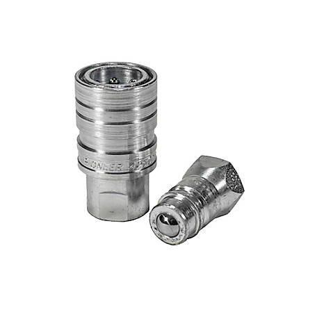

That looks like a pioneer coupler
Here is an image of pioneer

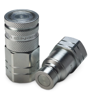

Here is a flat face connector

I’m trying to identify the kind of hydraulic couplers on my tractor’s 3rd function. Are the quick couplers in the photo “Pioneer Type”? The machine is an L6060HSTC with a Kubota 3rd function. Thanks for the help.
Hard to tell what they are from a picture. Most likely ISO 5675 agricultural couplers - aka "pioneer style". They are the cheaper ball valve design. What are you looking to do - purchase additional tips? If so you need to also determine what body size they are.
