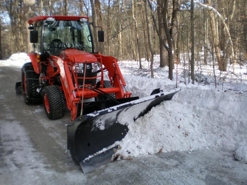

I have an old fisher 4way PA plow that I had a QA plate added and I use that on my FEL. With a box blade on the 3 PH my rig is a great snow mover.
