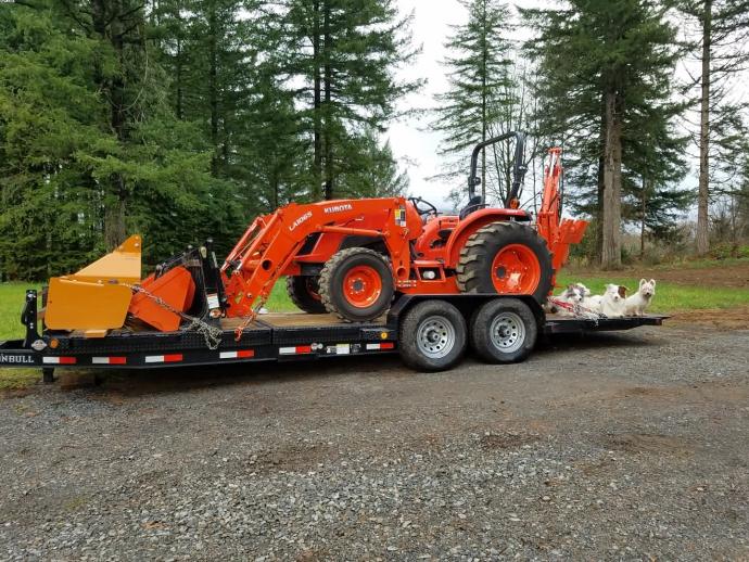

I bought a trailer last month to haul my tractors (MX4800 and BX266), and have used it about a dozen times so far. Here are a couple of things I have learned that may help you:
1. Double check everything just before you take off. Do a Walk Around the trailer checking everything.
2. Stop after a mile or so, and do another walk around, just to make sure everything is still tight.
3. Keep a large bag of zip ties in your truck, zip tie the chain binders closed, chains wrapped around them tend to vibrate loose, zip ties are cheap and secure.
4. I load my tractor on the trailer, put a chain across the front and fastened down, then back the tractor up to snug up the chain nice and tight, then lock the brakes. Then use binder(s) on the back. Simple and easy
5. you can roll your bucket back and stow gear, bags etc in it.
6. Take off your Slow Moving Vehicle Triangle and stow it in your truck. I had one blow off.
And have fun!

* Check your trailer lights during your walk-around, make sure you turn/brake, tail lights work. Never know if the wiring got pulled loose or bulb is out.
* Check your truck and trailer tire pressures before you start out, especially if your carrying a heavier load than normal. I run 80 psi in the rear Load Range E tires on my F250 and make sure the trailer tires at rated pressures.
The comment about checking your bindings after a mile or so, is golden. The load will always shift, and it gives you a chance to get another pull on it.
