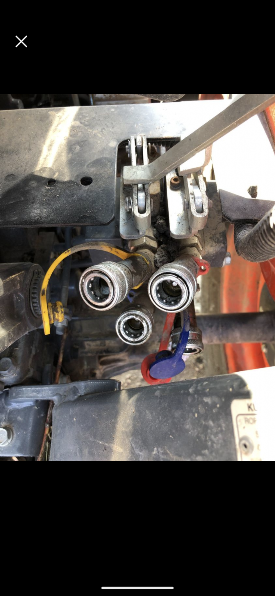

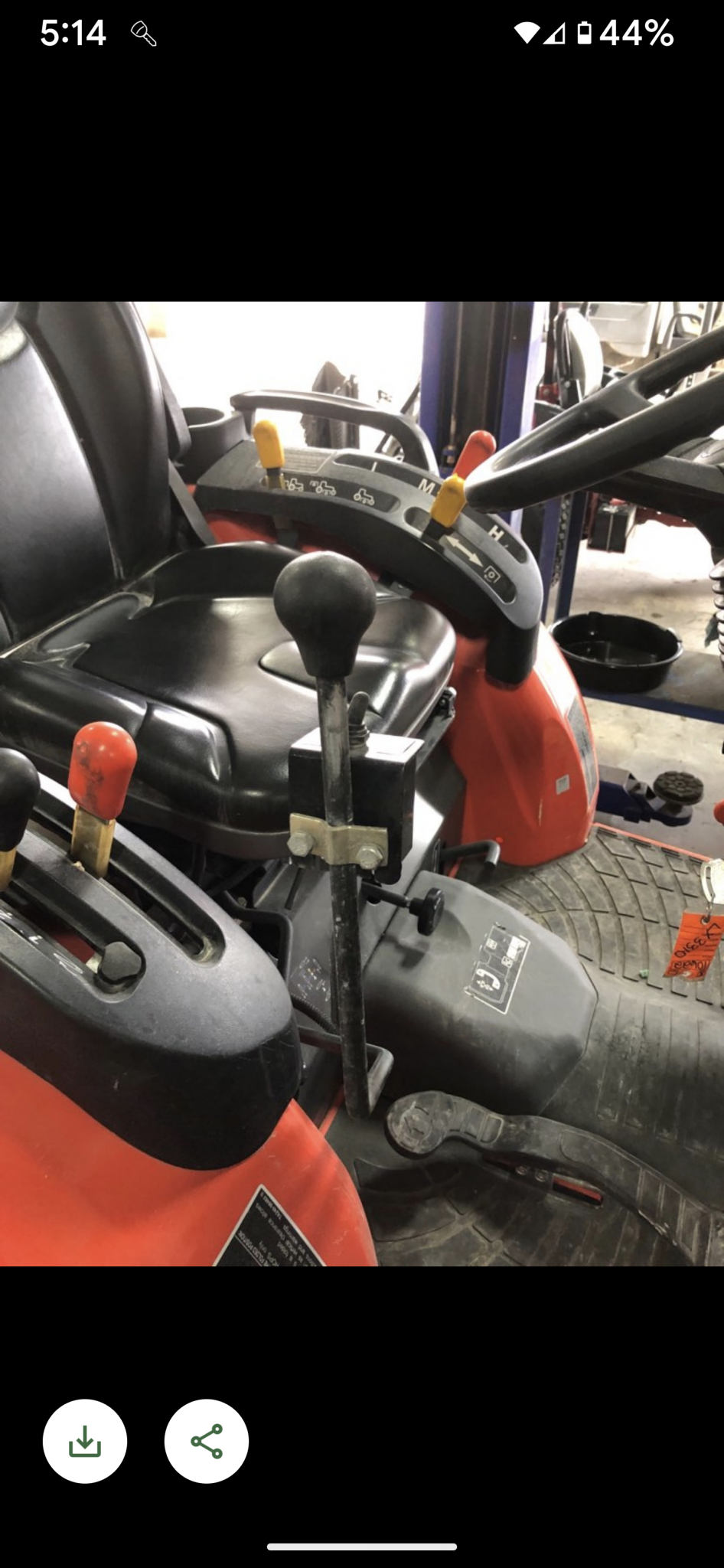

Seller doesn't know much about it, and am wondering about 2 pictures.
There is a switch on the loader control and 4 hydraulic connectors out back.
Can I assume 3rd function up front?
I've also only seen 2 hydraulic connections out back.... Not the 4.

The switch on the loader stick appears to be for a diverter valve. On my lx2610, this is used for the hydraulic snowblower chute controls. One direction is for left/right direction and the other is for up and down deflection.

Is a diverter valve the same as a 3rd function ?
No, the diverter uses the same hoses to switch between two fubction, a 3rd function valve adds another set of hydraulics to run a separate implement like a grapple.

I can’t think of a reason for a 3rd function without a loader.

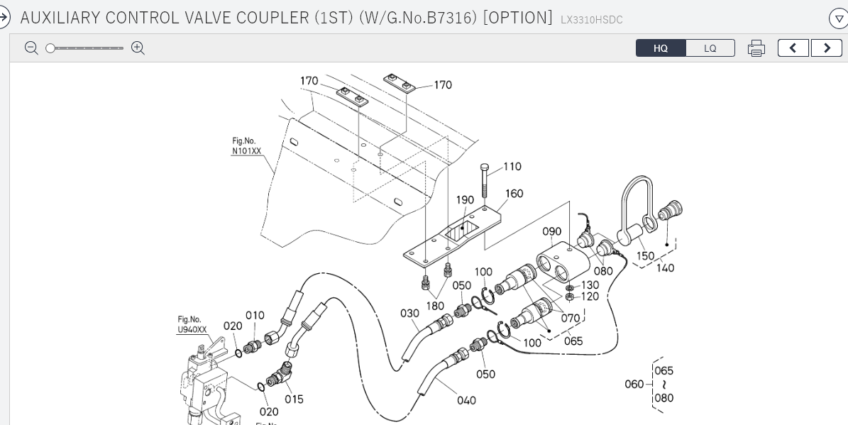

Also, those rear remotes are NOT factory/Dealer. The Dealer install will look like this. I have 2 rear remotes for a total of 4 connections.
Looks like it is to run the hydraulic spout deflector on the snowblower

Those rear remotes are Kubota ones. The ones used on cab tractors are different than the ROPS ones.
No, these are for the CAB models only, the open station are mounted down below just like in the photo.
10,875
5,974
The remote valves are factory for a ROPS machine. The valves are the same but the outlets are base mounted to the work ports on the valves rather than on the back using hoses and push/pull couplers and mounting blocks like on your cab tractor.

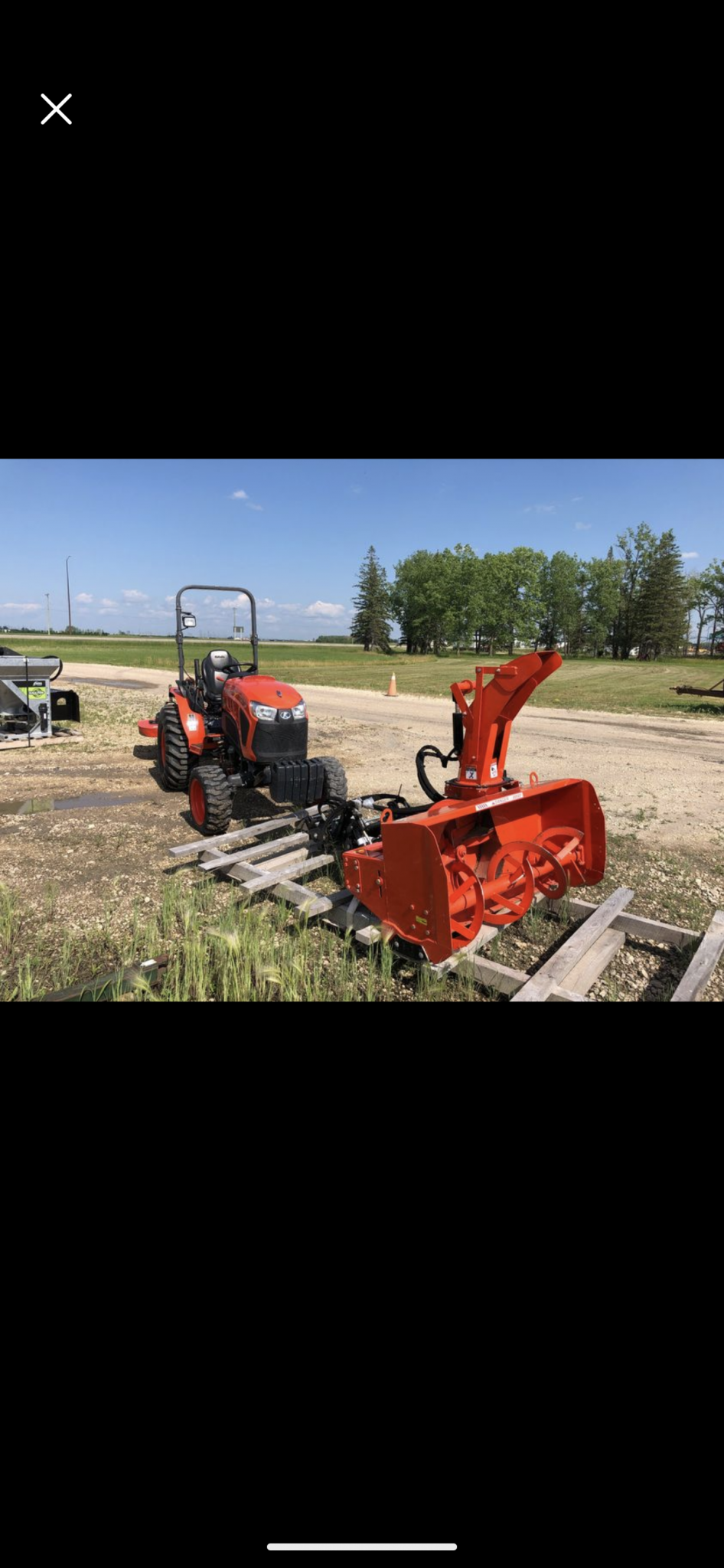

My loader hydraulic line connectors are what my B2782B snow blower's chute rotation and hitch lift cylinder are connected to. The loader curl function lines power the chute rotation, and the boom lines the lift cylinder.
