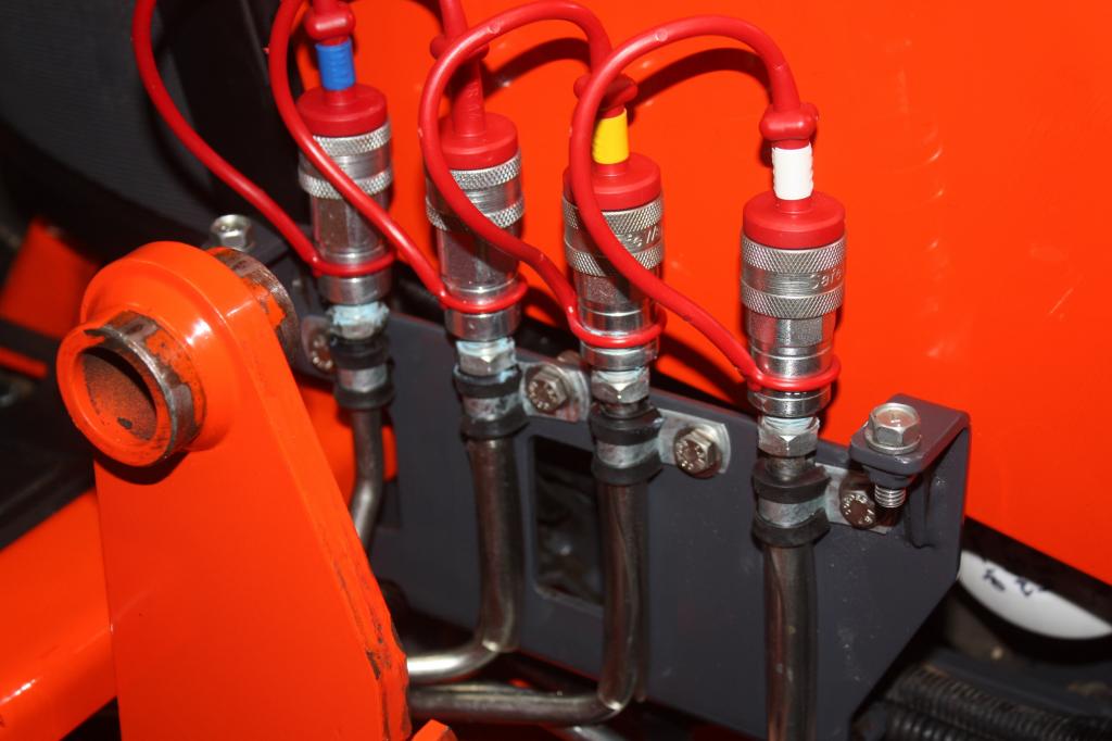

I fixed that problem once and for all yesterday
Except for the fact that pioneer style couplers are prone to leaking too. After time, they will leak like a sieve.

Perhaps, but they are easily serviced with new "O" rings commonly available.
If they need replacement, it is a $15.00 piece as opposed to a $57.00 piece at your friendly Kubota dealer.
Point being that after buying a "premium" tractor I really am not content to have it pissing out oil all over my driveway and garage floor. The dealer has had two attempts to fix it and Kubota continues to use crap parts without any solution on the horizon.

That single action quad connect is garbage..... from experience our 23s was replaced twice and the 2680 was 3 times..... 3 times in 14 months of ownership. It was leaking again when it got traded in. Every time warranty and they would just replace the entire assembly.

Thats crazy, my BX23S leaked once, as I didnt connect it squarely. Now I make sure its lined up and I reef on the ends. No leaks since. My biggest gripe is the paw loader mast lock. I almost bought 2 70 series loader masts and swapped them out to go back to a locking pin setup. Loader hasnt popped off more than once, but that was enough to shake my confidence in its long term reliability.
It’s certainly quicker than the old generations, but is the 5 minutes worth having a sloppy loader and leaky hydraulic connections?

I have a 3 set stacked with flow control valve on both my M's and they are Pioneer and they all will leak but as said, fix is quick, new 'O' rings, Takes about 30 seconds per connector and the 'O' ring sets are available about anywhere that has Pioneer fittings. I like Pioneer because they disconnect and connect under pressure and breakaway under stress conditions.
