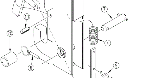

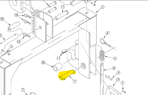

According to the part number you are talking about part number 7 on the picture below

You can get pin #6 MUCH cheaper at TSC. My HF QH had those push-on type pins (vs. the #6 that snaps back). Lost one of those, and the large pin almost came out. Replaced with a lookalike to #6 (from TSC).
I'd recommend getting some silver tape and taping over the #6s after they're snapped flat. That what I just did in moving the QH from the JD to the B. Had them taped after that pin came out on the JD.

I was able to use these in the lift arms
after mounting the QH15, I discovered that my bargain basement trailer hitch attachment was woefully too short to work, so I ordered a titan
Then I blacked out and woke up in the silly land of quick attach bushings. So I ordered two sets of these
PSA: make sure that second hand quick hitch has all the pins and bushings or it may not be quite the deal you think it is.
