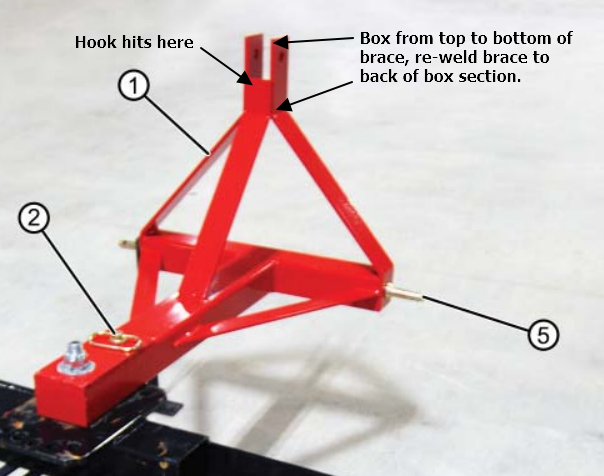

I bought a Titan Implement (not to be confused with Titan Attachements) 5107 84" landscape rake today. It claims to be Quick Hitch compatible, but it's not QH15 compatible. It looks like it could be modded to work with a little cutting and welding (I'm good at cutting, not so good at welding). The issue is the back of the hook is hitting on section of bracing that runs down to the section of box tubing that holds the rake.
Has anyone else modified one of these already? I'm thinking that a section of square tubing with one side cut out to form a deeper box around the back that the hitch can clear, then re-weld the brace to the back of the square tubing would maintain the structural integrity. Maybe if that's not clear enough, I'll do a mock-up with some cardboard and take a picture.
