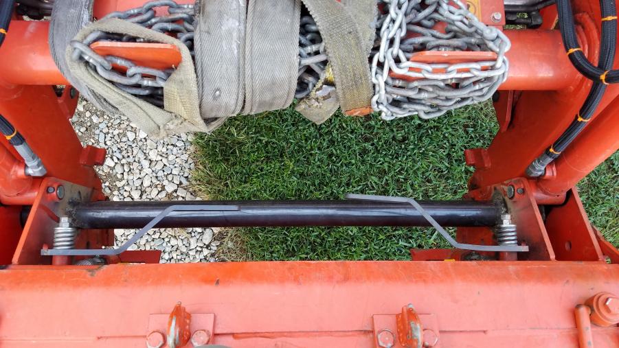

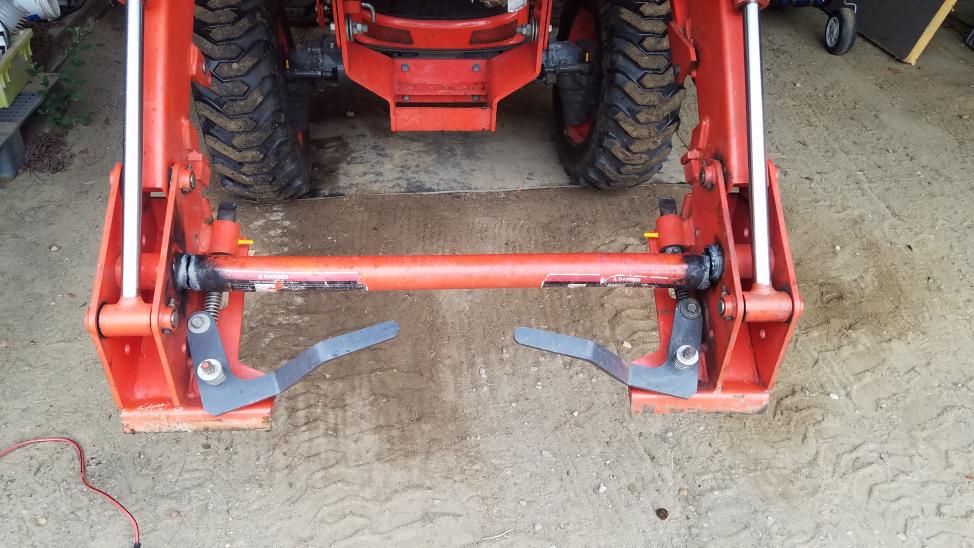

Looking at your first pic I think we can come up with a ring or strap or something that will hold the lever to the bar. To keep them from sliding inward and off the lever we need a catch or a way to connect both sides together. Perhaps drill a hole through the end of the handle to attach a short chain with a hook on the other end. I think a bungee or strap might be vulnerable to normal operation. Any of you fabricators want to come up with an idea and start production?

One guy welded a hook on the handle and using trucker bungee's. Another attached a steel ring with a short strap to go around the torque tube. I worry that a bungee would not keep it from getting dislodged by a branch. Most cases seem to be with grapples due to the type of work they are designed for.
