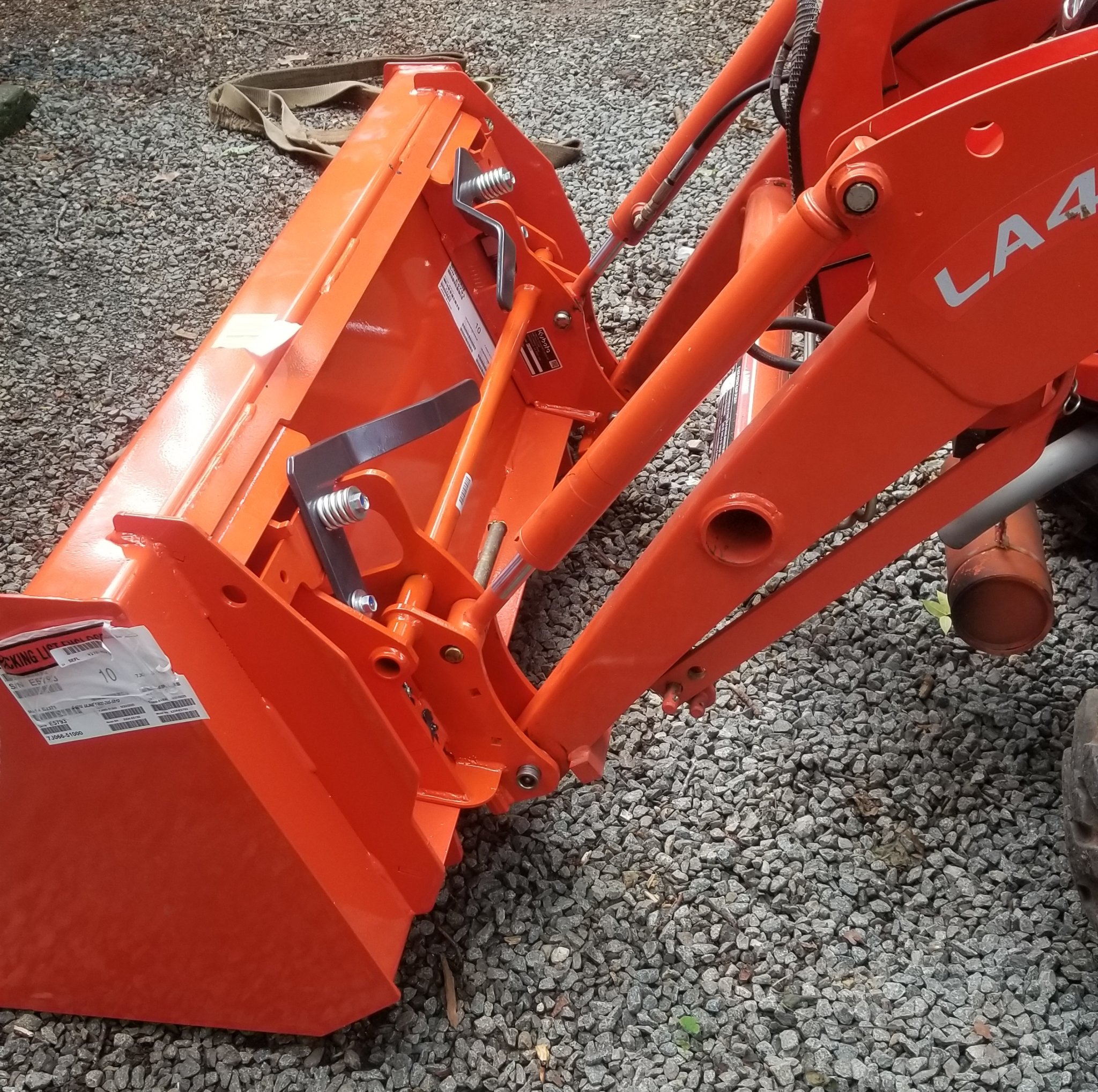

This should be a simple job. Remove old pin on bucket, install new SSQA plate assembly to the loader arms and then the new SSQA bucket attaches. I will then put my old pin-bucket up for sale.

All went well and as planned as far as install. Shipping charges, not very happy with but not worth arguing about with dealer. It appears there was a third item attached to my pallet that was removed, not sure if I paid for its shipping also.

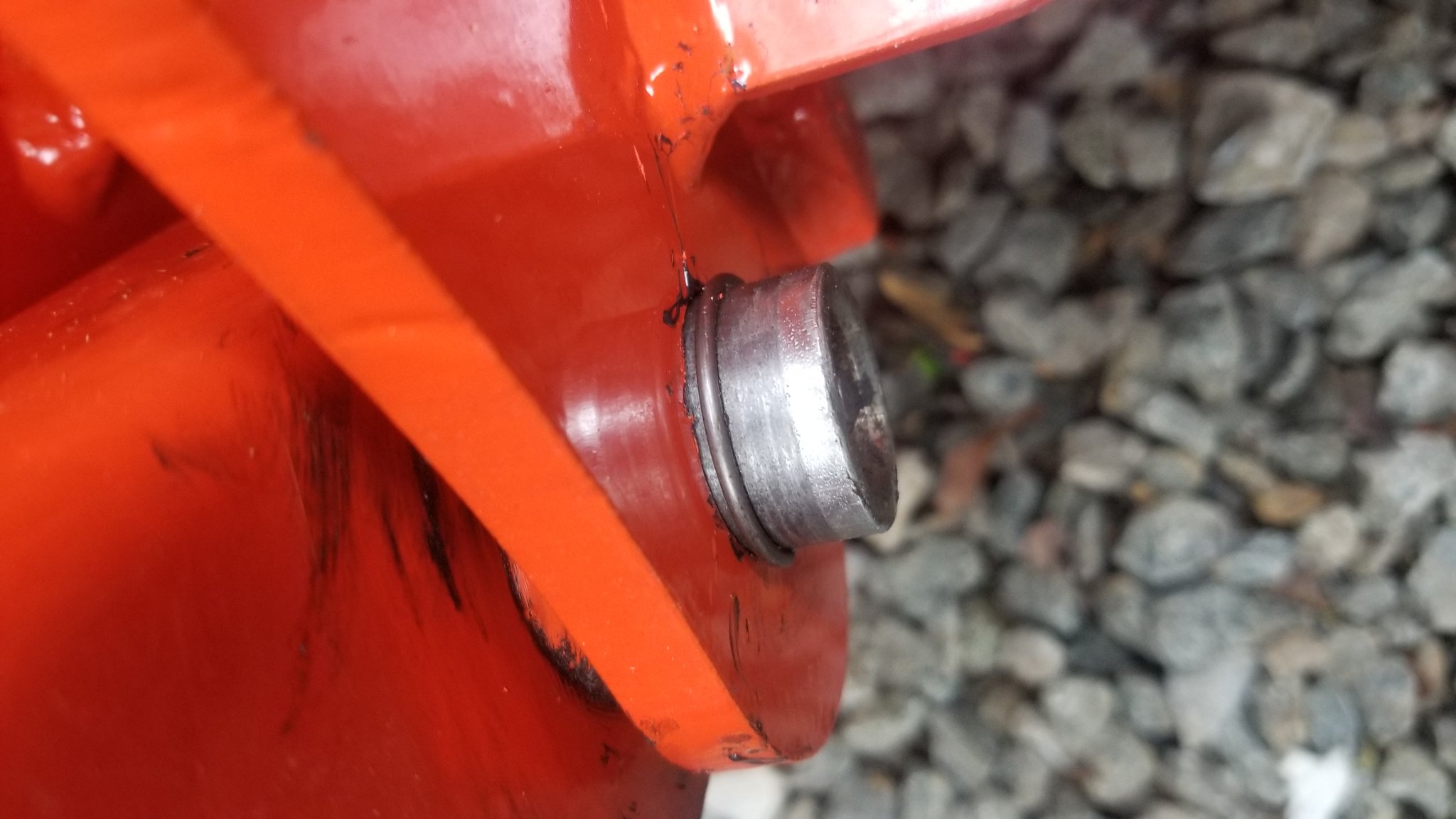

Finished install, had to machine a groove in the original pins for a c-clip so they could be reused. Did not buy new pins designed for new SSQA plate. Clips keep pin from sliding out.
