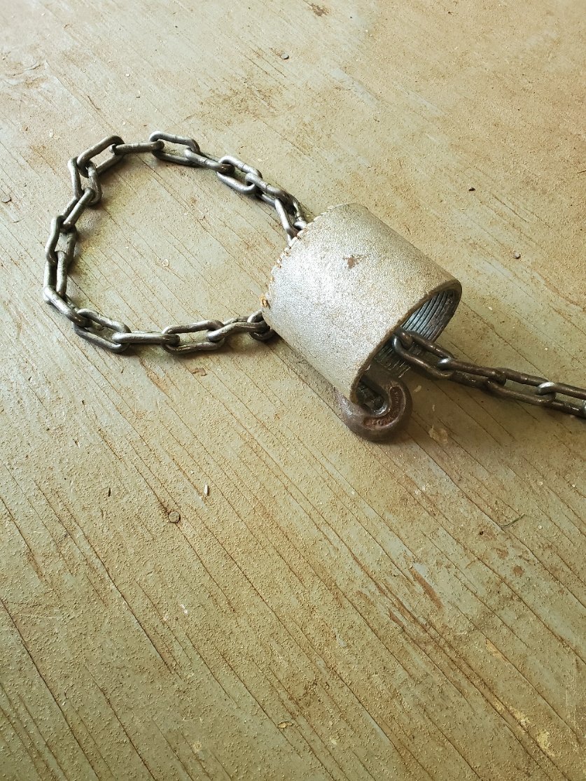

How would you hook a chain or rope to the base of a very young cedar so you can pop it out of the ground with a tractor?
I use a homemade grabber. It’s much faster than wrapping and tying chain, and it pinches the tree or shrub and the pipe digs in so the chain doesn’t slip. Just use a chain with a hook and slip it thru a short pipe. Wrap it around the tree and hook to on the pipe. Then pull….

I used to use a chain wrapped around the base of the tree and hook up to the 3 point. Now I am going to use the way that @Marky showed.

Thanks all!
I kept thinking the chain might just pull the tree over and slip off but it sounds like it will work. I've never seen a ring to slip over the chain like that before. Great idea!

My 2" coupler just arrived. I'm ready!

Just tried the chain and pipe coupler. Brilliant!
Thanks again guys.
